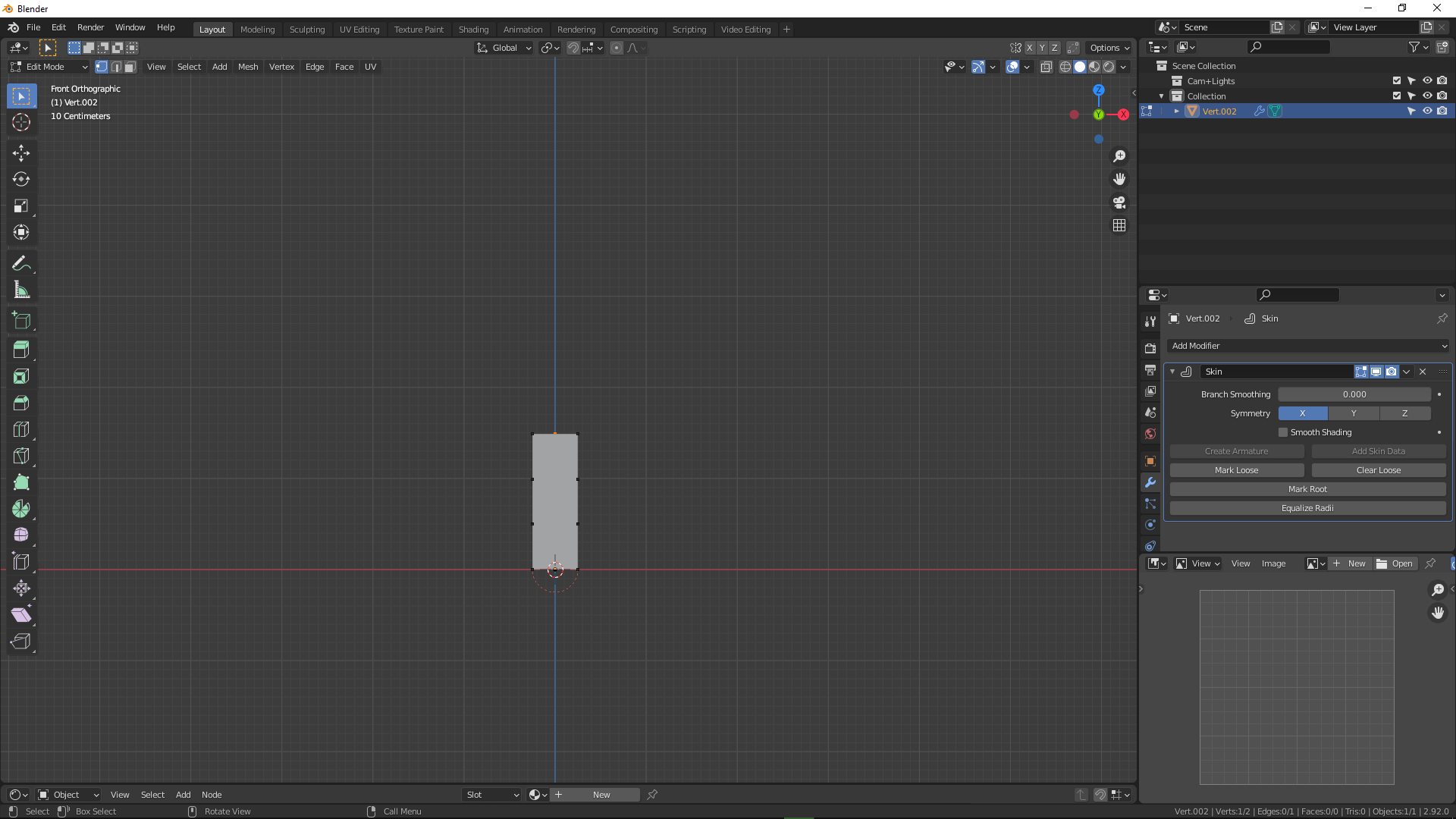

      Hello.  I noticed that when I use the skin modifier, I only get three sections compared to six in the tutorial.  Is it necessary to make some setting adjustments to get the same number of sections?  Thank you.

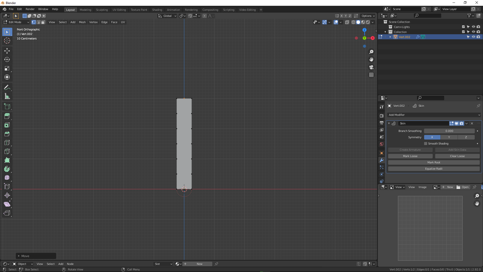

        Hey @ennstar , the number of segments is consistent with the distance between verts.
        Notice here 👇 just moving the extruded vert higher, will result in more segments.

          Oh wow, didn’t realize it was something that simple to fix.  Looks like if I scale up the reference image by 2, the number of segments matches the video.
          Thank you for the solution!
