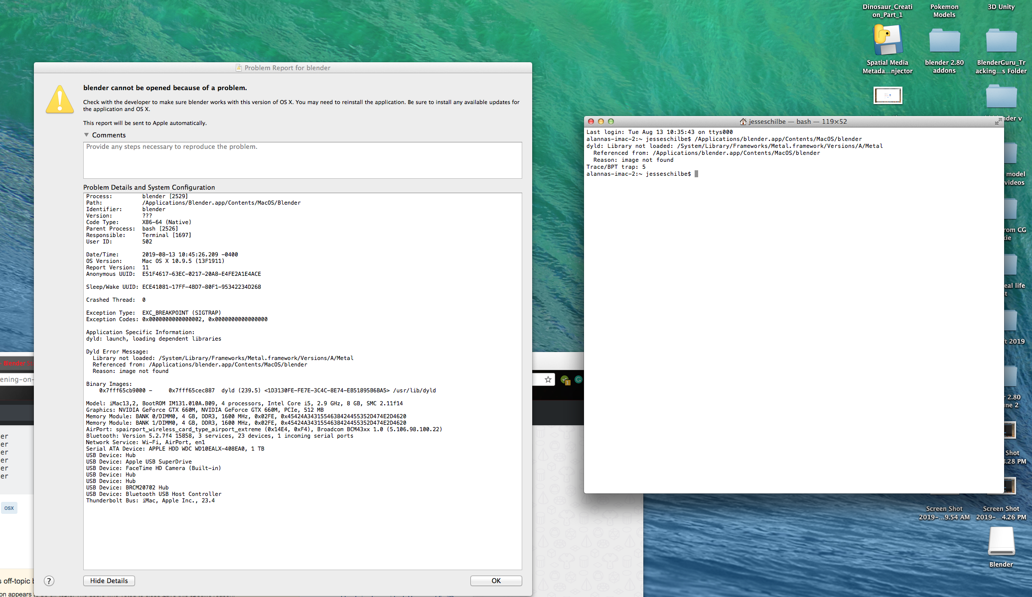

Blender 2.80 full release is not opening on my mac am running an iMac osx late 2012 version 10.9.5 Macintosh HD with a 2.9 GHz Intel Core i5 Processor and 8 GB 1600 MHz DDR3 of Memory and an NVIDIA Geforce GTX Graphics card I tried restarting my mac and I also tried re-downloading blender 2.80 here is what it says when I try to open blender in the terminal
On the Blender website it says 2.80 needs macOS 10.12+
But I know nothing about mac, so…
@spikeyxxx thanks I missed that info on there webside

@spikeyxxx I got blender 2.80 to work I was afraid that all of my other apps will not be supported if I upgraded my iMac but in the end I gave in and upgraded my iMac and it seems like all of my other apps work fine and now I can run blender now
