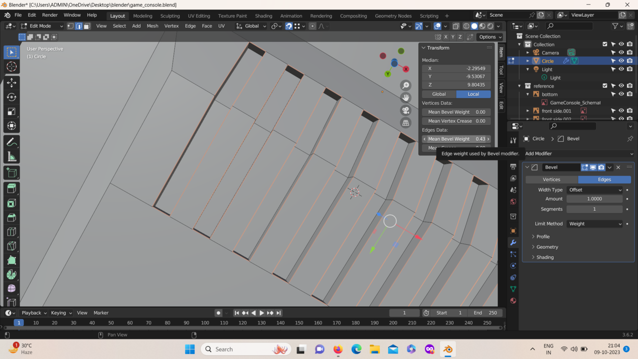

      at 9:20 in this video ,  bevel on edges is not effective

        Adrian Bellworthy
          You may have double vertices. Select everything with A, then M – by distance.
          #81568
            What, you started with a Circle? (Nothing wrong with that…just weird 😉)…
            You may also have Clamp Overlap enabled (under Geometry in the Bevel Modifier)…
            But, looking at your Transforms, my first guess, would be that you didn’t Apply your Scale…?
            #81569
              Also maybe if the scale is off, if your object is too tiny, you may need to set the numbers at very low values, stuff like 0.003
