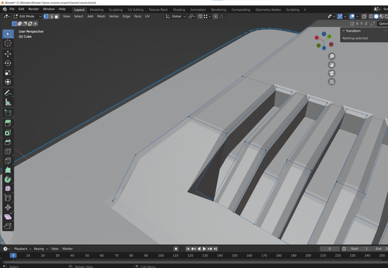

      my bevels on the edges are weird.
      #78165
      v i

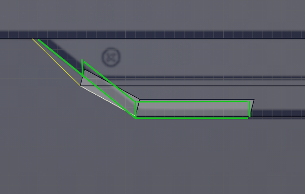

          Hi vi @SuperNova ,
          Have a look at this post;
          https://cgcookie.com/community/14683-i-cannot-beval-the-slots
          It is not unlikely that you have an angle like this:
          but look at all the answers; some useful information there.
