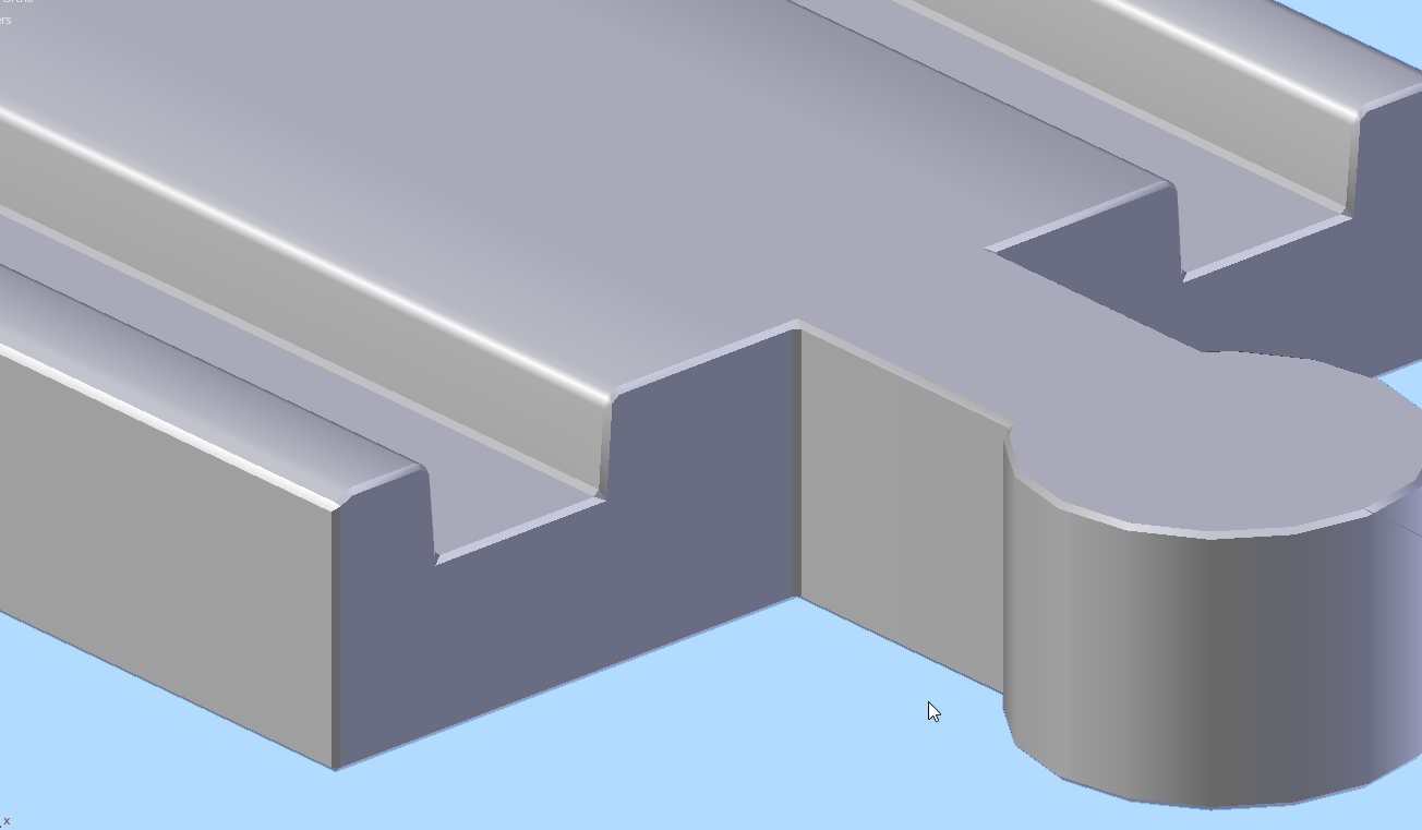

    I’m currently trying to create a toy track system. Building the low poly of the straight track was rather easy, but now I’m fiddling around creating the high poly (to get some small bevels) and this is were I’m getting stuck constantly at the moment.

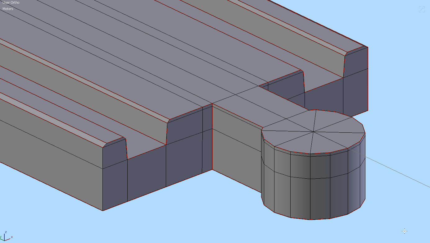

    This is my low poly model:
    I see that the small cut at the top could get in the way of any bevel.
    But what would be a better way to create this?

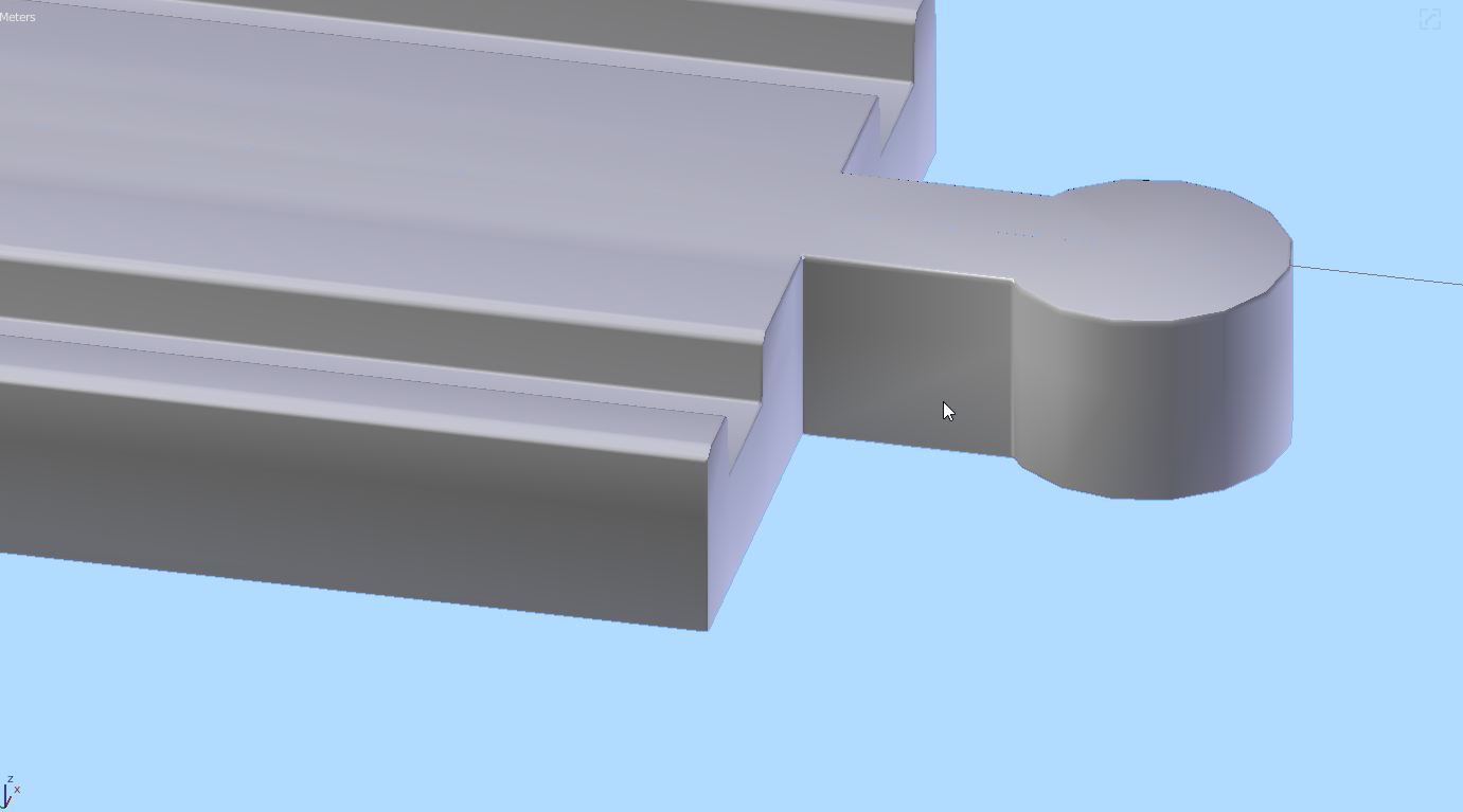

    Adding a bevel modifier with one subdiv already gets a little bit wonky

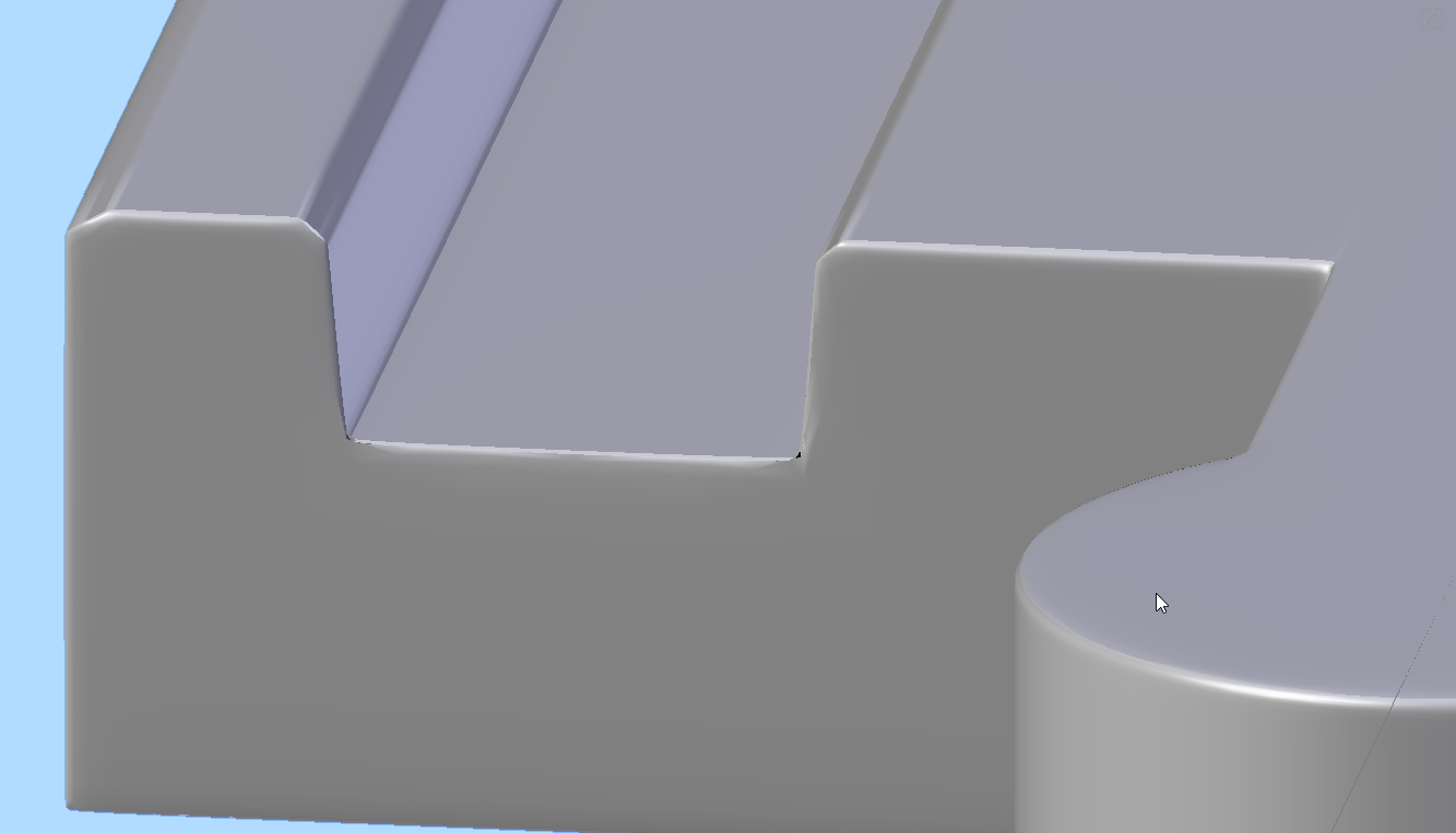

    Adding a second subdivision to the bevel gets really weird. the front part seems to get no rounding at all, but it gets divided (I used angle limit here but tried weighting too)
    Finally adding a subdivision surface modifier really “destroys” the geometry…see the corners…

    What’s the best way to create the low poly model so I can work with a bevel modifier / subdivision surface modifier?
    I worked around this adding manual cuts for the high polygon model, which worked okay’ish…still got some shading errors, but this would get really bothersome when I want to create curves.
