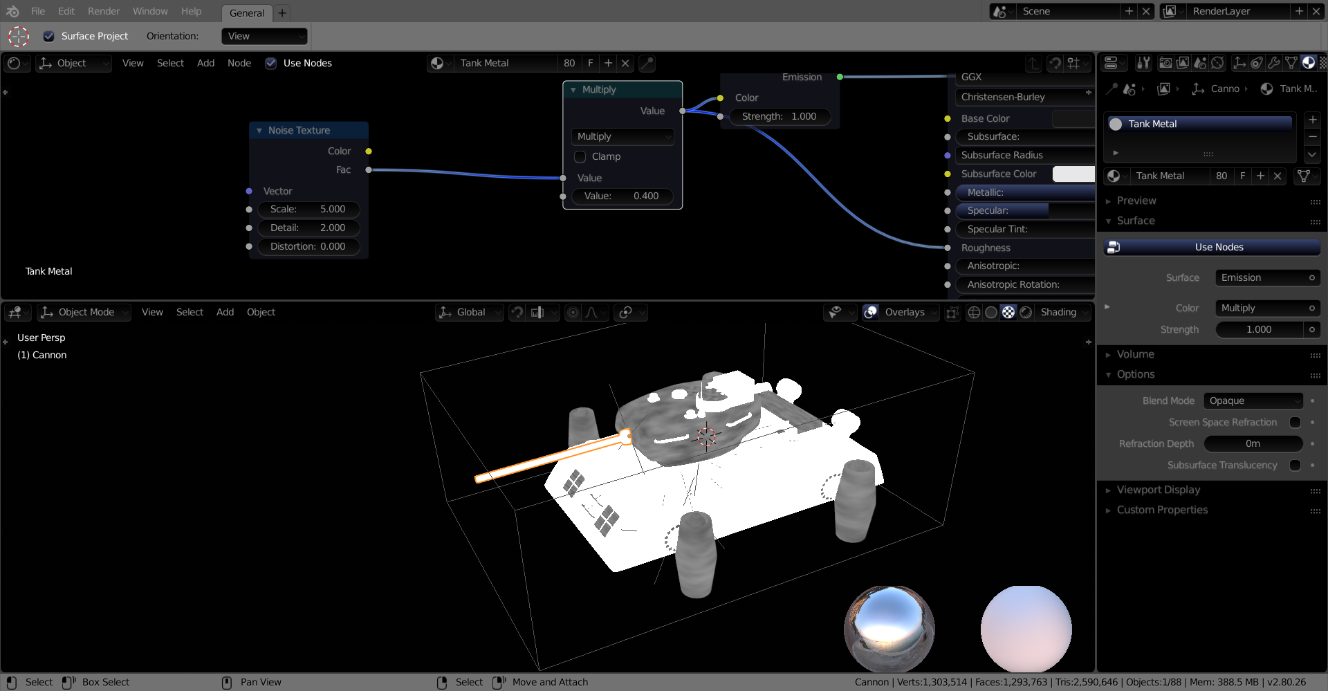

                    I’m getting this weird bug with EEVEE.  All objects have the same material, but some look different than others.  The texture spaces have all been corrected.  How can I fix this?
                    #42910
                    William Miller
                      Also, none of the default HDRIs look good because I want my tank to be black and reflective, but I can’t seem to get enough reflections from the world.
                      #42911
                      Dragonice
                        @williamatics I happened with my shading as well. I noticed that if You will unwrap everything and scale UV islands “upside down” if You know what i mean it solves that.
                        #42912
                        William Miller
                          @dragonice69 It didn’t work.
                          #42913
                          Jake Korosi
                            @williamatics I hate to say this, but you may have to start from scratch with the materials.  When I imported my truck into 2.8, the interior materials for the fabric and leathery-vinyl were just…wrong, all wrong.  And I couldn’t tweak them to make them right; I ended up having to build new materials for them.  Most Cycles materials seem to import into Eevee just fine but a few don’t work at all.
                            #42914
                            smurfmier1985
                              @williamatics @jakeblended I’m afraid Jake is right, experienced this too. I also noticed that the scales of textures is messed up. Where I used a scale of 10 in Cycles, I had to bump it up to something ridiculous like 100-300 to get the same kind of effect in Eevee, so that might be an issue too.. Also some nodes and values don’t work (yet) in Eevee, like the AO node and the Pointiness value of the Geometry node.
                              #42915
                              William Miller
                                @jakeblended I wasn’t moving them to EEVEE from Cycles, I was starting from scratch.
                                #42916
                                Grady Pruitt
                                  when things aren’t looking the same when they should, I always check object scale and normals. Most of the time, one of those is the culprit.
