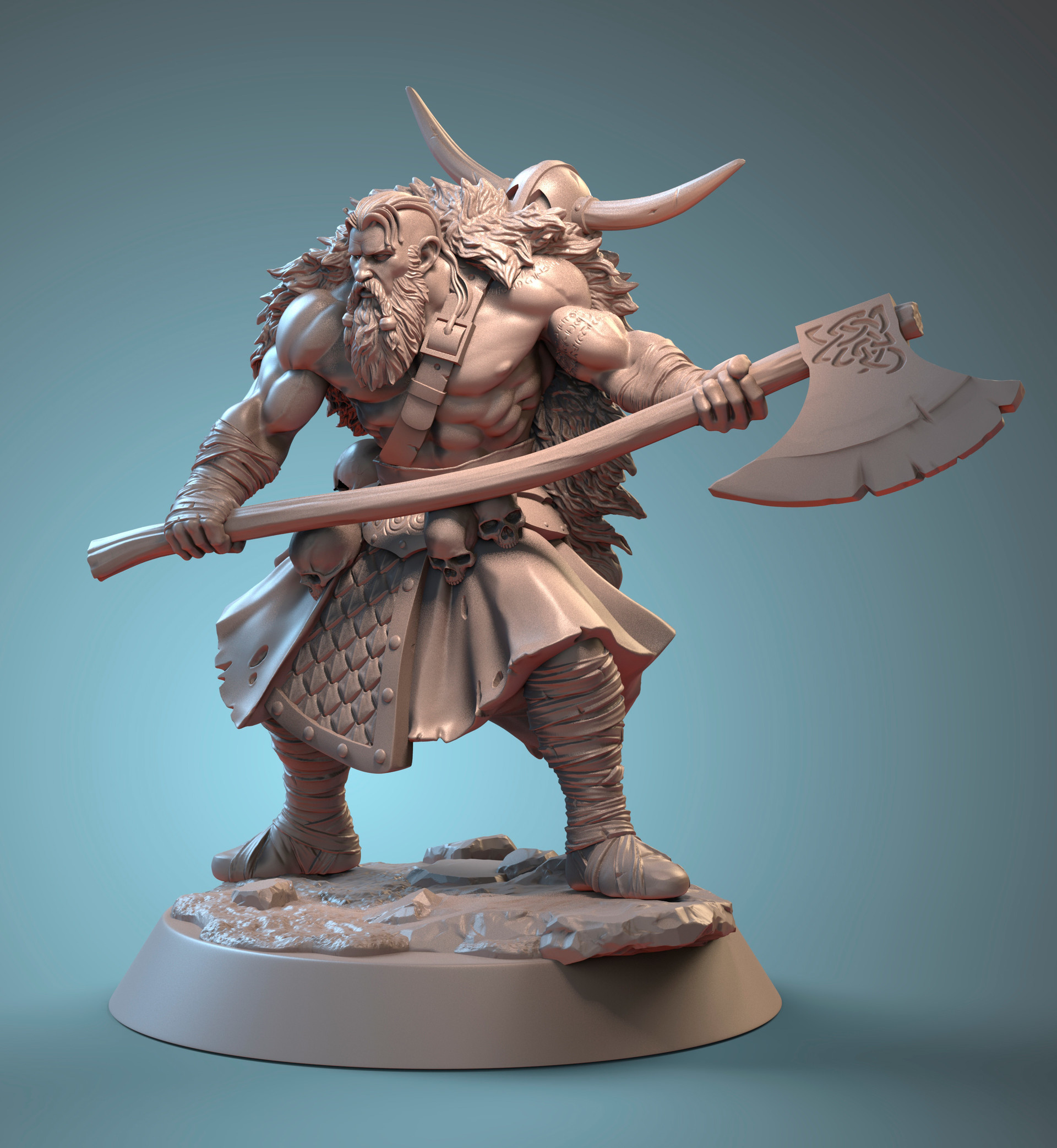

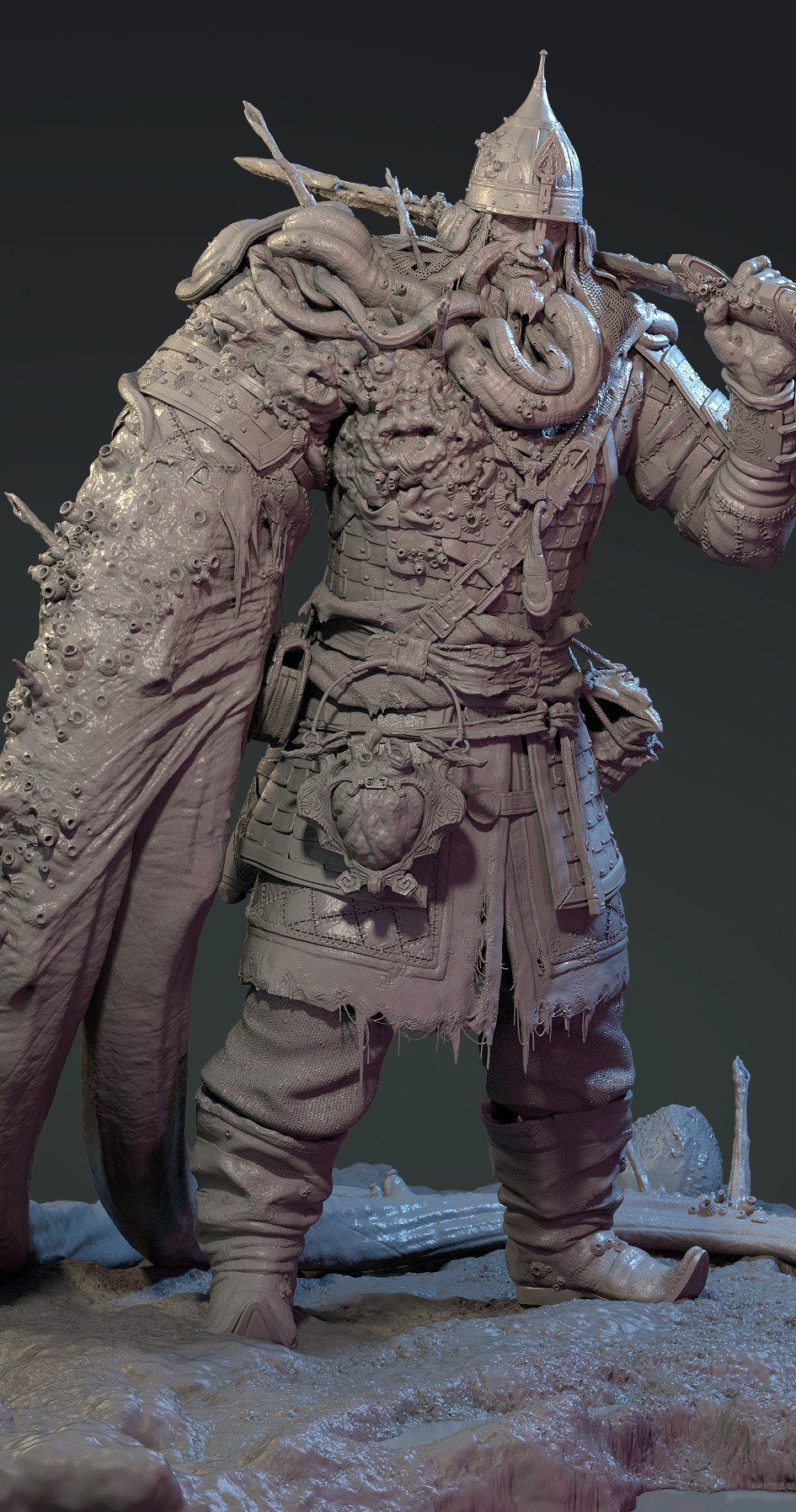

      Hi, what do you think of these two possible images to light match?
      #42567
      smurfmier1985
        @tomaslapes I think they’re both good choices. Each has different colors of light which will be fun trying to match, so go with the one you like the most 😊👍🏻
        #42568
        Grady Pruitt
          @tomaslapes I agree with @smurfmier1985 .. In fact.. the one on the right was the one I used on my second attempt.

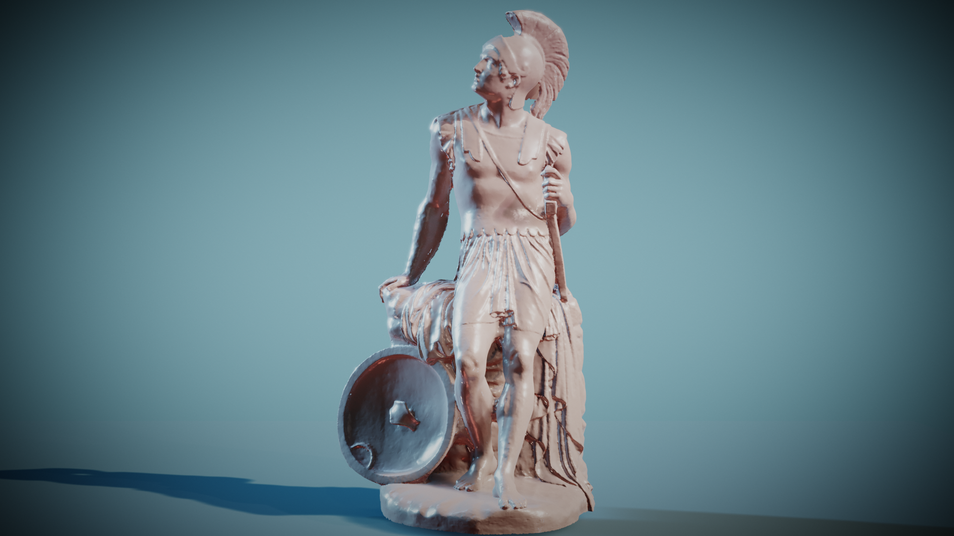

            My result:
            ORIGINAL:
            Hi, this is my submission to the light match exercise.
            What do you think?
            Credit for the model: Geoffrey Marchal
            #42570
              @tomaslapes Great choice for light match. It’s a very strong character presentation. You also picked a good model for matching.
              Overall it’s a good job matching – certainly in the right direction. A few notes:
              1. Shadow are sharper and darker than the source. The floor is the biggest giveaway where shadows in the source image are much softer. Also the left shadow in the source is barely there but it’s very dark in your render. This must mean that another light source coming from screen-left isn’t strong enough to nearly wipe away that shadow on the floor.
              2. The color of the key light is not as warm as the source. It’s quite yellowy-orange in the source and seemingly closer to white in your render.
              3. Key light position feels like it’s too much in front of the character, causing him to be flooding by that singular lamp more than any other. Whereas the source character has a lot of shadow play in the front, suggesting the keylight is directly above his left shoulder, pointed mostly straight down.
              4. Last thing is the framing. If you don’t need a 16:9 ratio, go ahead and chop off the empty space on the left and right like they did with he source render.
              Still it’s a good effort in the right direction. It’s a B in my book for this part of the homework.

                @theluthier Hi,
                what type of lamps should I use? In my result, I used sunlamps because I find area lamps hard to work with.
                #42572
                Thomas Lapes
                  I don’t know why but with EEVEE I always have this washout look to everything I make.

                        @tomaslapes A little late to the party.  The car looks pretty good.  The lighting match still feels off to me, but I’m not sure why.
                        #42576
                        Thomas Lapes
                          @silentheart00  Yeah I know but I can’t figure out why.
                          #42577
                            @tomaslapes I know what you mean. I believe the reason is that for people who are used to Cycles and its out of the box global illumination, Eevee not having it (nor a great way to emulate it) is a confusing way to light. The first thing I do with Eevee is enable Ambient Occlusion because without it all shadows look washed out and nothing feels in proximity. That’s the kind of feeling I get from your render as well. Aside from AO be sure you use Area lamps and enable contact shadows at the bottom of the area lamp’s settings.
                            Your car is looking great! Seems like you harnessed Eevee quite well there. Overall you’ve done great work this week and you get an A from me.
