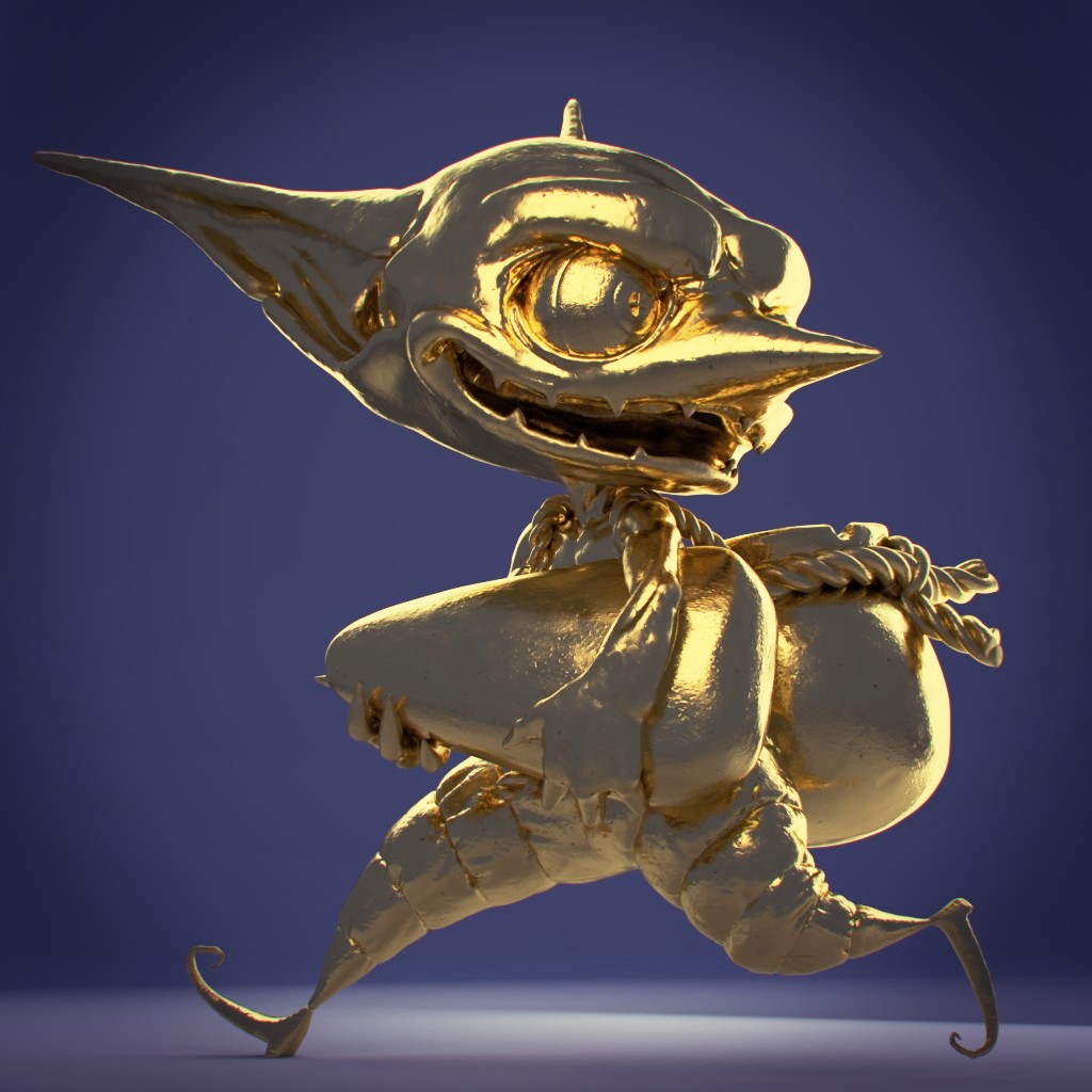

                    Week 3!!
                    Shade & Light a Character
                    This week I picked the “Made you look”  genre to make a golden figurine

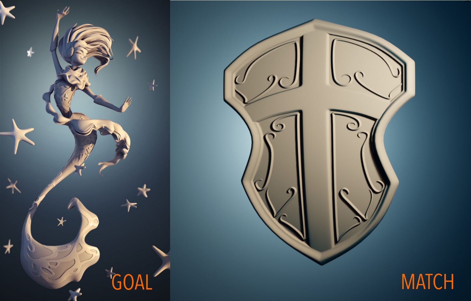

                    Lighting Match #2
                    Image credits: “Mermaid” by Brittney Lee
                    #43047
                    smurfmier1985
                      @tcmpinheiro Oh cool! Hadn’t seen a golden one yet, I like it 😄
                      #43048
                      Grady Pruitt
                        @tcmpinheiro Interesting take on the lighting and materials for the goblin. Nice job on it!
                        One of the things we noticed last week is that it’s really hard to judge light matches when the source and result subjects are this vastly different. That said, I think the gradient in the background on yours is definitely a brighter color as well as wider spread. Kind of hard to judge the lighting on the shield in comparison to the source, though.
                        #43049
                          @tcmpinheiro Nice job on your “made you look” character render! The gold reads very well; very believable. Do you have a HDRI environment in the scene? It looks like the gold is only reflecting the lamps and a blue-ish color.  That’s my only note, that I’d like to see more sings of an environment in the reflections. But it’s a small note honestly. You’ve earned an A in my book.
                          I really like the source image you chose to match. It’s a very appealing presentation. Unfortunately your shield – though I’m glad to see you did that tutorial! – is a pretty big disconnect from the source context (character). That makes it difficult to A) setup matching light and B) discern how much it matches in the end. I can see that your background is slightly more greenish in color and i don’t see much evidence of a blue fill light coming from the left like I do in the source. Overall it’s a B from me.
                          Solid work overall. One more week – keep it up!

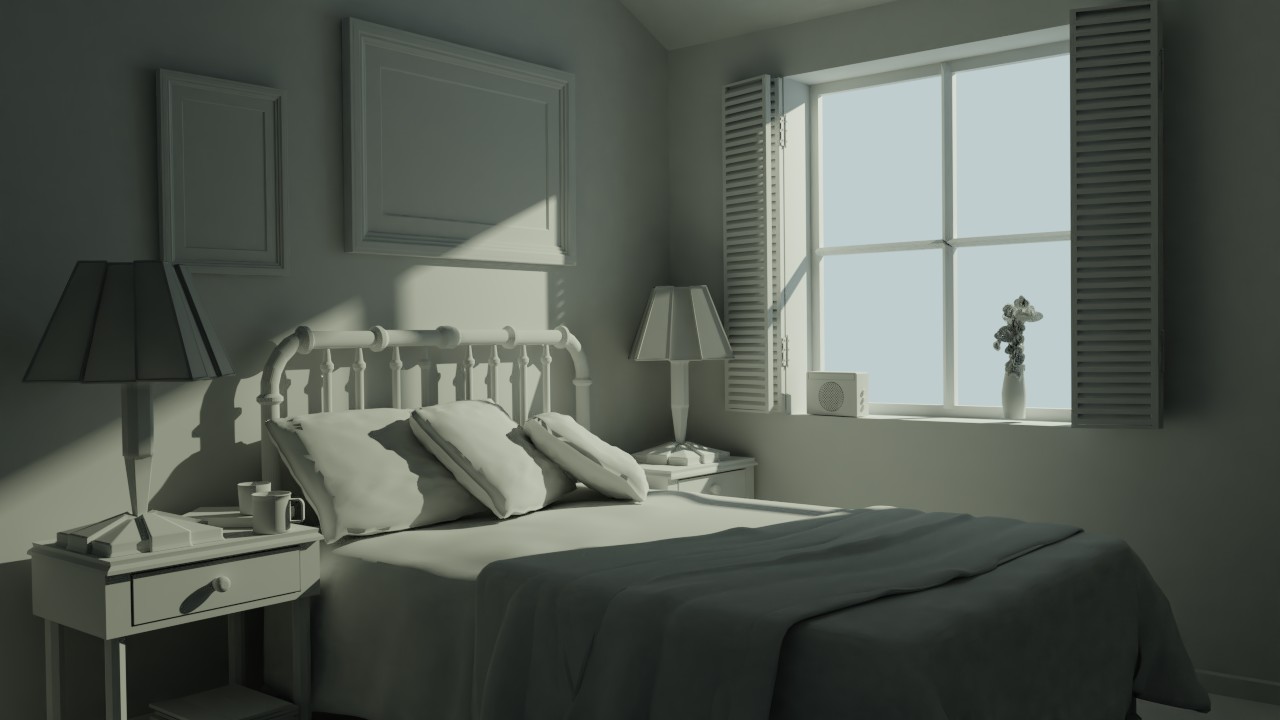

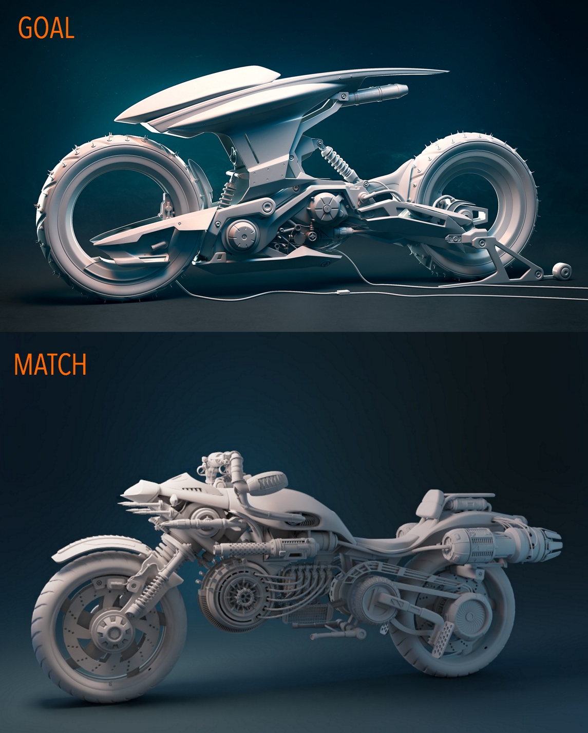

                            Week 4
                            Arch Viz scene
                            Lighting Match #3
                            Image credits : “Sci-fi Motorcycle” by Mike Hill
                            Motorcycle model: “Rocket bike” from ChrisKuhn
                            #43051
                              @tcmpinheiro Congrats on submitting homework all 4 weeks, Tania! You’ve done a lot of good work this month.
                              Your arch viz is looking good. Certainly in the believable realm. A couple notes from me:
                              • In between Black and White and Color. Most of the image is greyscale in color scheme with the contrast of the purple accents. So it creates this interesting juxtaposition, almost like a scene from the wizard of oz when half the world is in color and half the world is black and white. Or that image filter that lets us isolate a certain color while desaturating everything else. All to say it’s interesting but less realistic.
                              • In between finished and WIP. Clearly some materials are finished as intended, like the grey trim paint with a nice touch of glossiness. However others look like a default grey, like the toilet for example, which should be highly reflective like plastic/porcelain. It leaves me not fully knowing if the image is finished or a work in progress.
                              Overall it’s a B+ from me.
                              Your light match is fantastic! Definitely one of my favorites from the month. You’re super close to the source. Good work: A+.
                              Looking back through your thread, you’ve been fairly quiet this month, speaking louder with your renders than words. Which is fine – I hope you enjoyed the class 🙂
