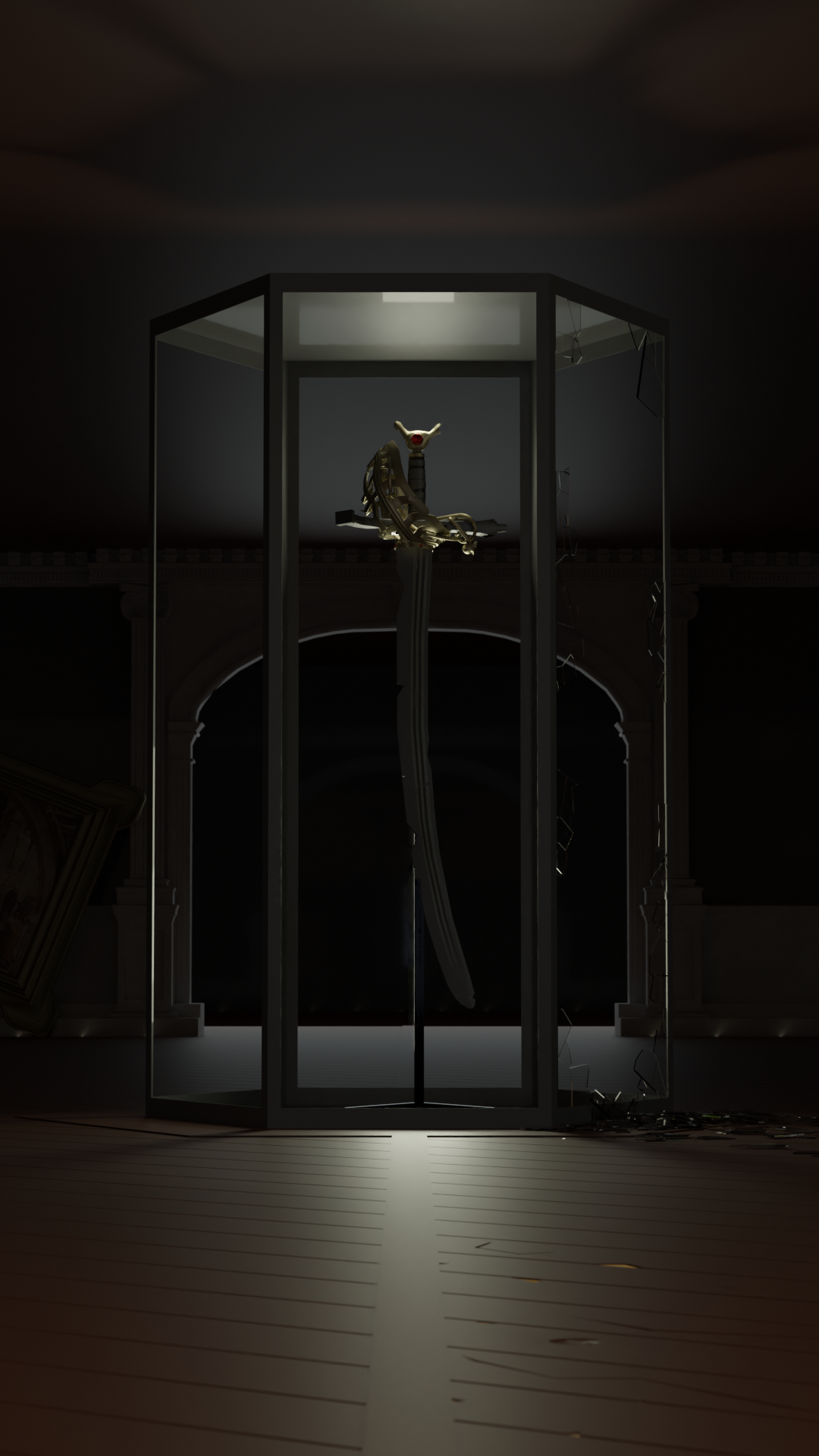

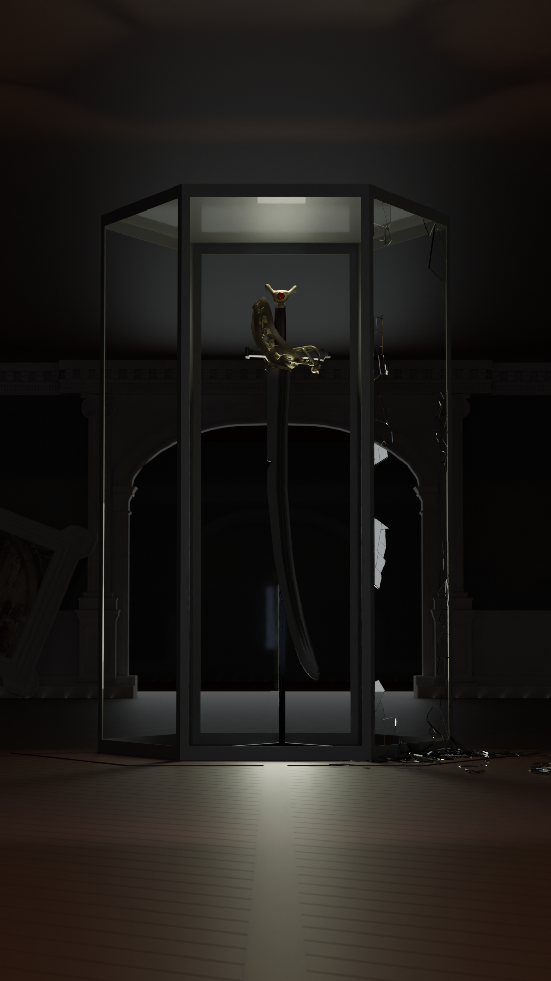

                  Homework Week 1 Submission
                  So not gonna lie, little bit disappointed with how the turned out. Stuff like I didn’t get to finish certain parts like the floorboards (though I can always add to that in the coming days), not adding more to the background (see previous) and the sword overall feeling… bleh to me, at least when I compare it to the other submissions. Maybe I can use the stress and inexperience with low poly as an excuse? Maybe I’m too hard on myself? I don’t know, but what I do know is I must do better.
                  I tried experimenting with volumetrics for creepy fog but it wasn’t working out plus really long render times so I decided to put that on the backburner for now. I was also debating writing the story now but I feel a lot of said story will also be told through the textures and overall atmosphere of the finished scene so I’m gonna hold off on it for. But if you look closely, you may be able to figure a few things out for yourself…

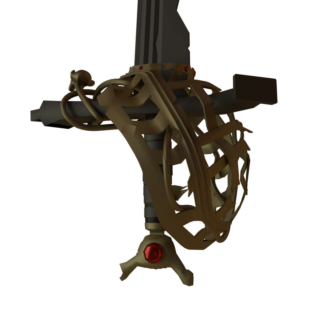

                  Here’s a closeup of the hilt area, which arguably has the most detail on it:
                  Like I said, disappointed with the modeling overall, so I’m praying my texturing skills will be able to carry me and make it look halfway decent. I look forward to your judgement and hopefully you can steer me in the right direction, maybe I can even apply some of it before the next stream? Thanks in advance.

                    @thecabbagedetective Now that I’m seeing the final model, you picked a complex one for sure. That ornamental hand  guard is tricky stuff. Considering that, you pulled it off quite well!
                    I’ve got two main notes: First, a potential damage inconsistency. The blade looks like it’s been to hell and back while the handle and looks relatively unscathed. I see a tiny nick in the pommel, but by comparison to the blade it’s notably undamaged. You could either add damage details to the handle for consistency or remove most of the damage from the blade. Or meet in the middle: Add a little damage to the handle and remove a little from the blade.
                    Second note is about the lighting. Really it’s a week 3 exercise, but since you’re starting now you’ll have plenty of time to polish the lighting. Currently the lighting is lacking focus and proper value range to me. The center light on the sword is providing decent rim light but there’s not enough showcasing the sword as a whole. So it get’s a bit lost, fighting for attention with the rim light on the case and most-lit area (the floor). Here’s couple images from my reference collection that could help:
                    None of them are featuring a weapon but they’re all silhouette-heavy with dark ambient light and strong key liights. The illumination from below in the last one could be a cool way to light your sword in the case (like a light panel as the floor of the case). Do your own thing though!
                    As for a homework grade, you have definitely earned an A. Way to go, sir! 👊

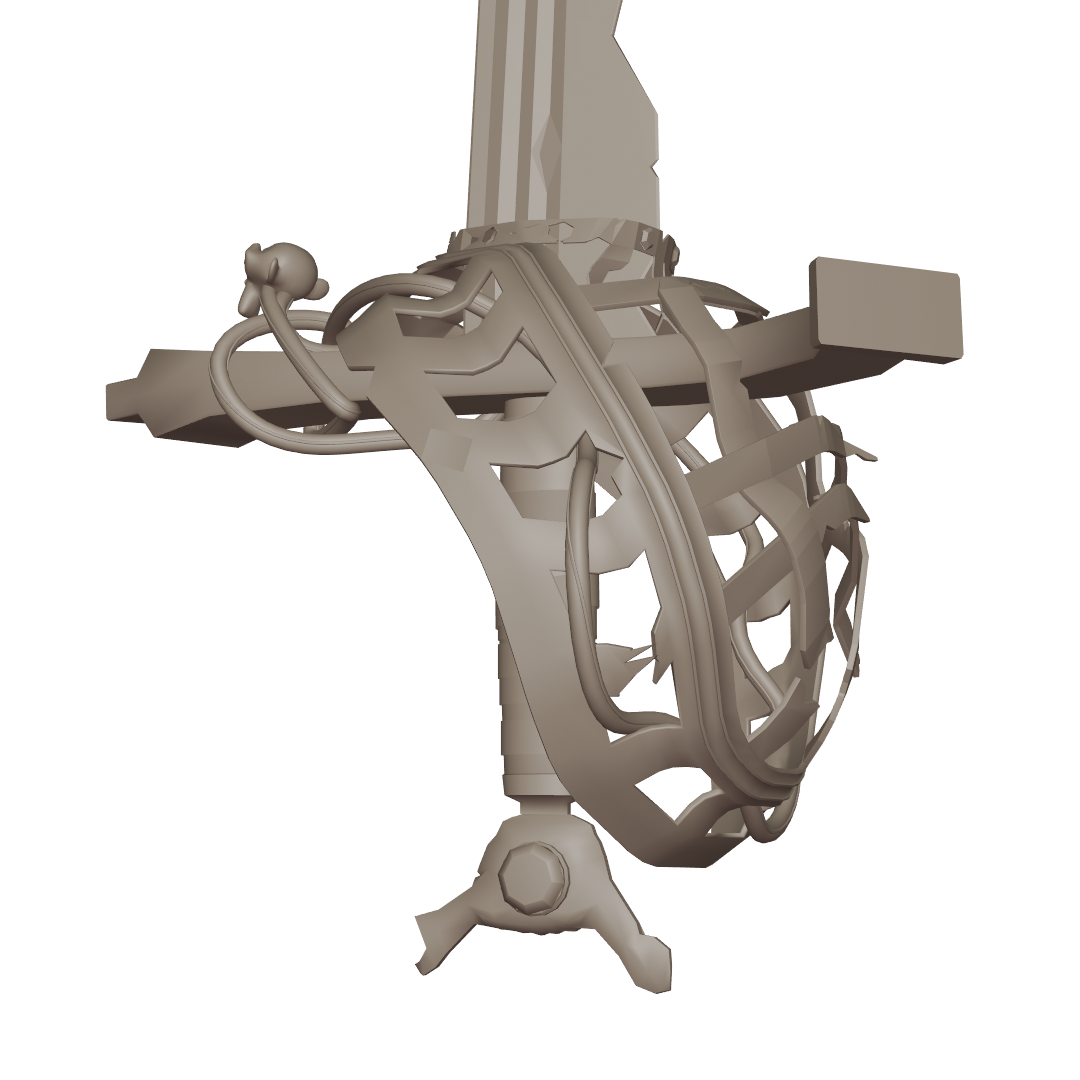

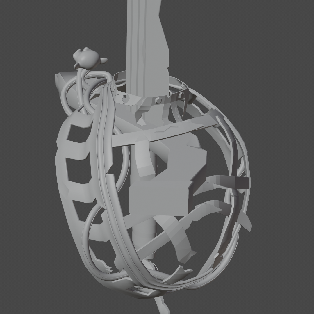

                          Aaron Rudderham
                            @theluthier Thank you very much for the feedback! I’ll be sure to do better next time.
                            Also for the record that whilst the non-blade has damage I defo agree it needs more work. Here’s another angle on it.
