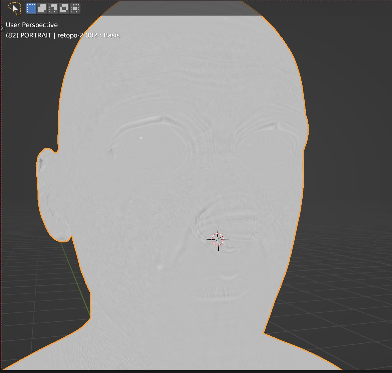

      When I baked skin_utility_DISP-B at Viewport level 2 and Render level 5 (max), I got some weird banding on the nose and brow. Any ideas what might have caused this?
      #74397
      fearguyq
        Here is the model at level 5 and level 2 and edit mode respectively

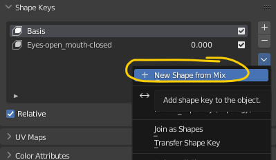

              The culprit appears to be the shapekeys. It’s creating a discrepancy between the multires data and the base mesh. Which makes perfect sense in hindsight. To solve this:
              1. Go to your shapekey panel and create a new shape from mix.
              2. Next delete your previous 2 shapekeys with the “-” button, leaving your new shape from mix only. Then delete than one last. This process essentially “collapses” your shapekeys into a consistent base mesh.

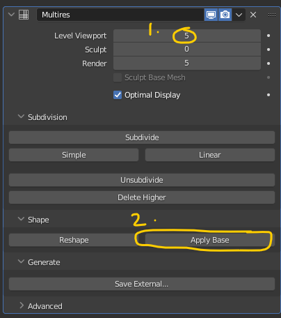

              3. Next go to your multires modifer, change your viewport level to the highest (5) and click Apply Base in the “shape” section:
              4. At this point you should be able to bake cleanly with your viewport level at 2, render at 5.
