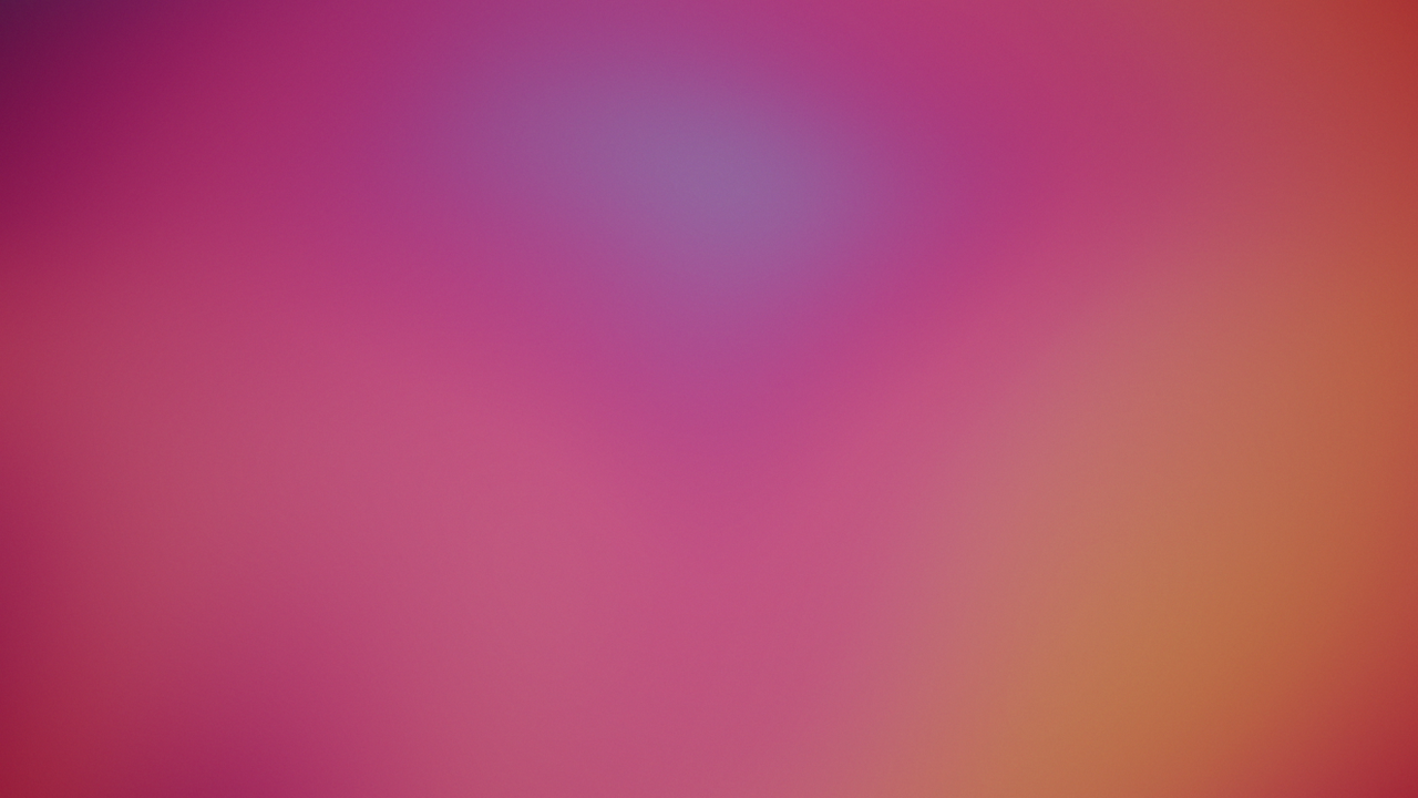

      I’ve noticed both in the tutorial video and when I render the animation of the Looping Patterns Blobs myself, there is banding in the rendered out video – is there any way to get rid of the banding? I tried different export settings like “high quality” and “lossless”, but I can still see banding. Any tips would be much appreciated, thanks!

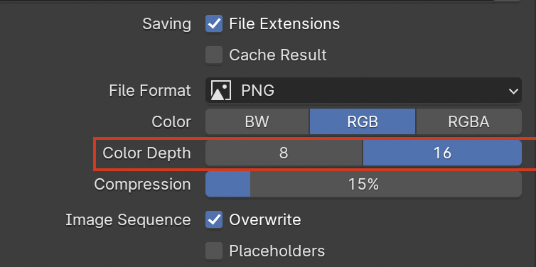

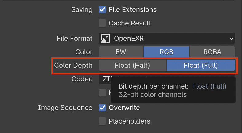

          When ever you see banding it’s typically the color depth that is causing it, so not enough color information. Try rendering at 16bits or 32 bit float. The PNG’s format can go up to 16bits and Open EXR can go the full float 32bts. Files will be a lot heavier in megabytes though, but you’ll get much more quality images without the banding.

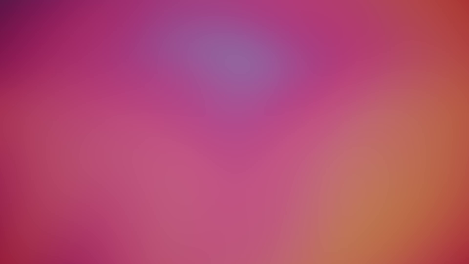

                Here are some snapshots of the results
                H264, png-16
                apple pro res, png-16:
