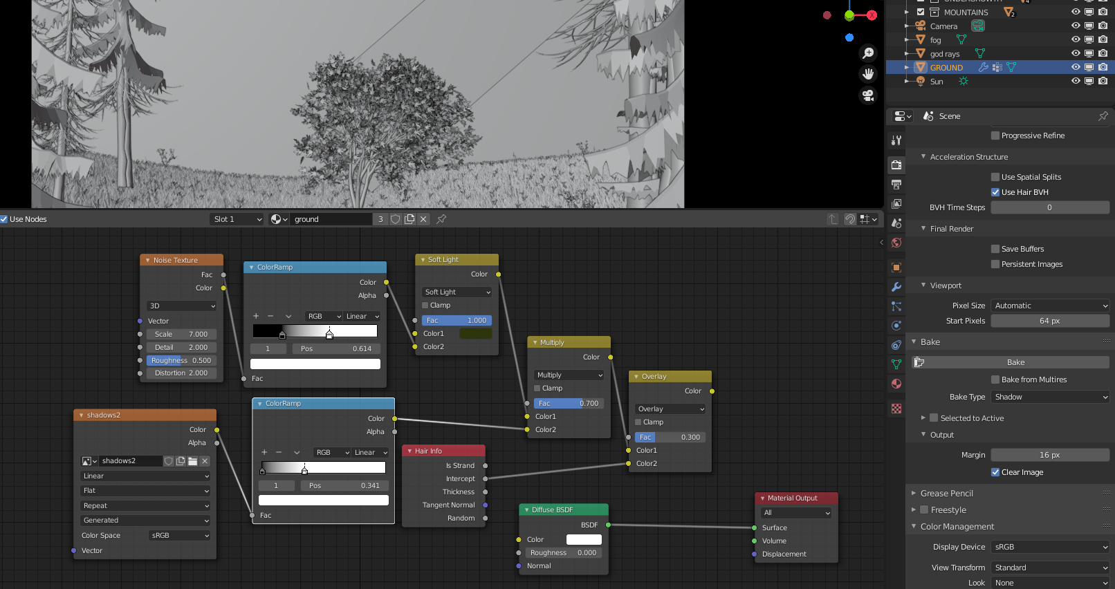

      I followed the instructions to a t, but it still gives me a black image. Any ideas what i might be doing wrong or which setting i might have forgotten to change?
      I do use the “diffuse BSDF” to bake as he said in the video.
      #67880
        Can you post a screenshot of your Shader Editor (at least, the whole UI would be even better…).
        #67881
        uesomat
          #67882
          uesomat
            I hope you can see everything you need to see
            #67883
              @uesomat I haven’t baked shadows before, but I think it is, because you don’t have the Image Texture Node, that you want to bake to, selected. You can’t bake to a Colorramp 😉

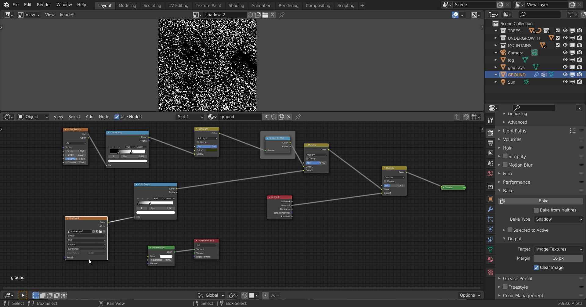

                i tried it with the selcted Texture Node, with the Diffuse Node selsected (as in the video), nothing changes. I do have a sun light in the scene so that is not the problem here. When i bake it combined it gives me some light pixels on the right side of the baked image.
                #67885
                  This is what is essential for baking:
                  If you could provide a link to your .blend file (via Dropbox, or Googledrive, or so…), I will have a look, because apart from the fact that you didn’t have the Image Node selected, I can’t find anything wrong in your screenshot.

                    #67887
                      Bakes perfectly fine:
                      Look at the outlined Image Texture Node, that means it is selected.
