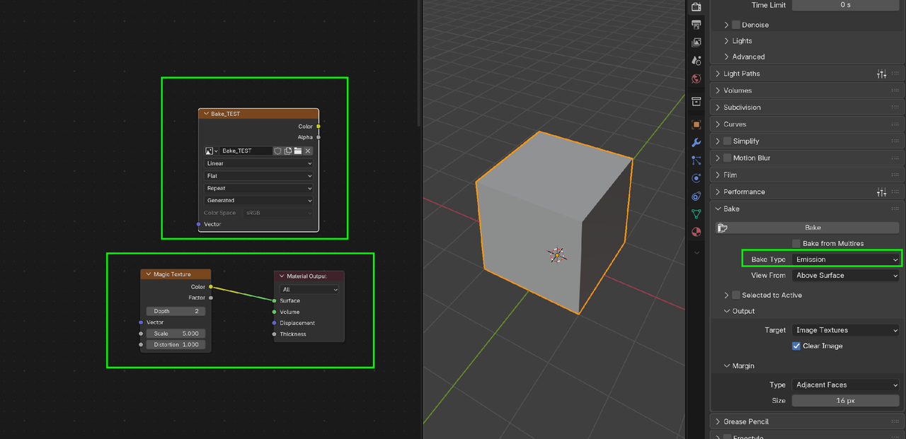

Maybe you don’t have any Light in your Scene.
You could also Bake it like this:
That would give an Albedo Map.
