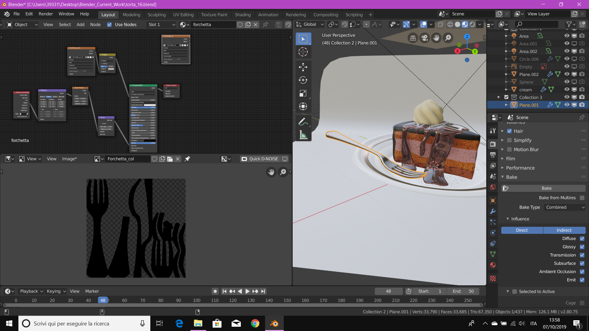

      Hello guys! I’ve got another problem…I’m trying to bake a texture from a material that I created, but the texture turns black and I don’t know what can I do with that. Need help!

        @korneisgibnev098 Hi, can it be that you disabled rendering for Collection2, that contains your Lights?

            @korneis glad it worked! When you look at the Screenshot you provided, you can see in the Outliner, that rendering for Collection2 was disabled, so If you didn’t have any other Lights in your scene, that would have caused the Bake to be black…
            I don’t think you need to update Blender;)
