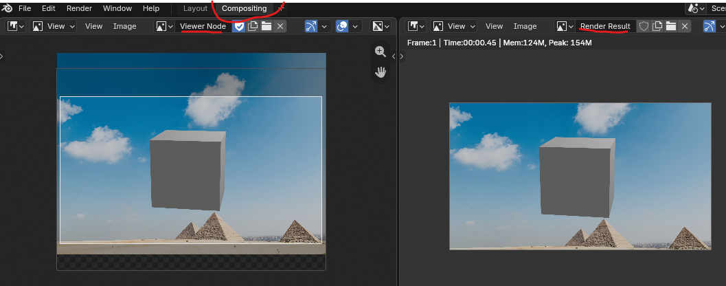

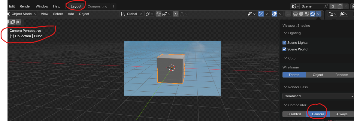

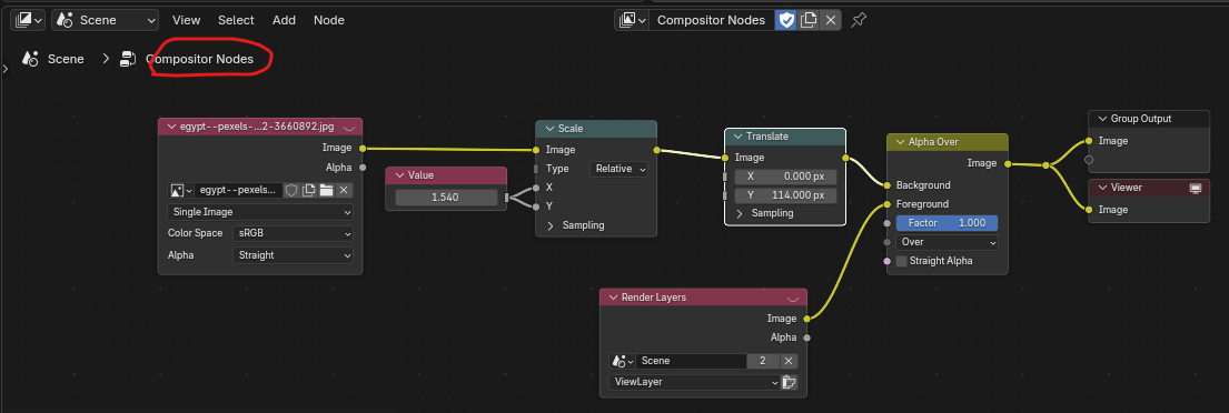

          1. Compositor nodes:
          2. Views in Compositor tab:
          3. View in Layout (Camera view):
          #133646
            Hm,
            Try this: Add another Scale Node set  to Render Size after the Scale and Translate (before the Alpha Over), to match Compositor and Viewport. You’d have to adjust the first Scaling, but hey, it’s probably the easiest way to do this.
            #133647
            Kevin Mather
              This seems to work. Thanks.
