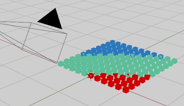

      (I’m using 3.6.7 LTS.) If I use input “Camera Data: View Distance”, I get odd results. For example, in Ortho:Left view, if I pan the 3D viewport the values seem to stay put while the objects move. They look kind of spherical. The effect is more obvious if stepped a ramp with Constant interpolation is used.
      If instead I use “Geometry: Position: Y” (and adjust the range), I get the desired results. Of course it is decoupled from the camera position.
      Am I missing something?

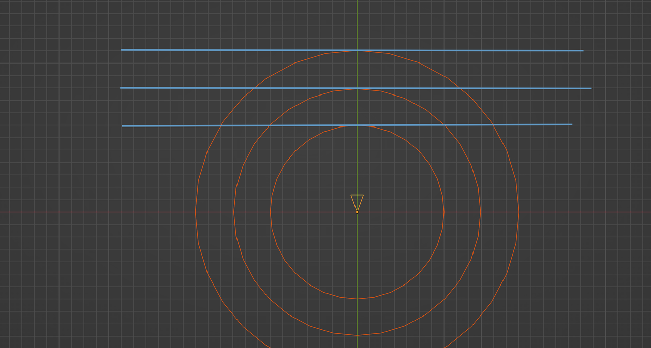

        Hey @techworker ,
        View Depth is, how far away in the Cameras Z-Axis something is (blue lines) and View Distance is how far away something is from the Camera (red circles):
        Now, this all isn’t applicable in Orthographic View…(think about that…)

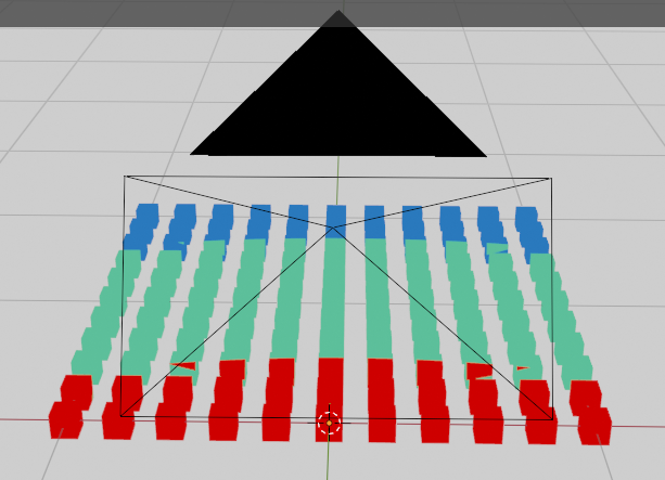

          Hi, I did some further testing and confirmed a suspicion (surprising): the distance value appears to be relative to the viewport rather than the camera. Two test examples are below. (You need to multiply/add, differently, to get the ramp in range.) This explains the bizarre behavior I was experiencing. I don’t think I have missed a setting somewhere. Perspective/orthographic seems to have no effect.
          For a render, I guess it wouldn’t matter. But it does make setting up the material more difficult and confusing.
