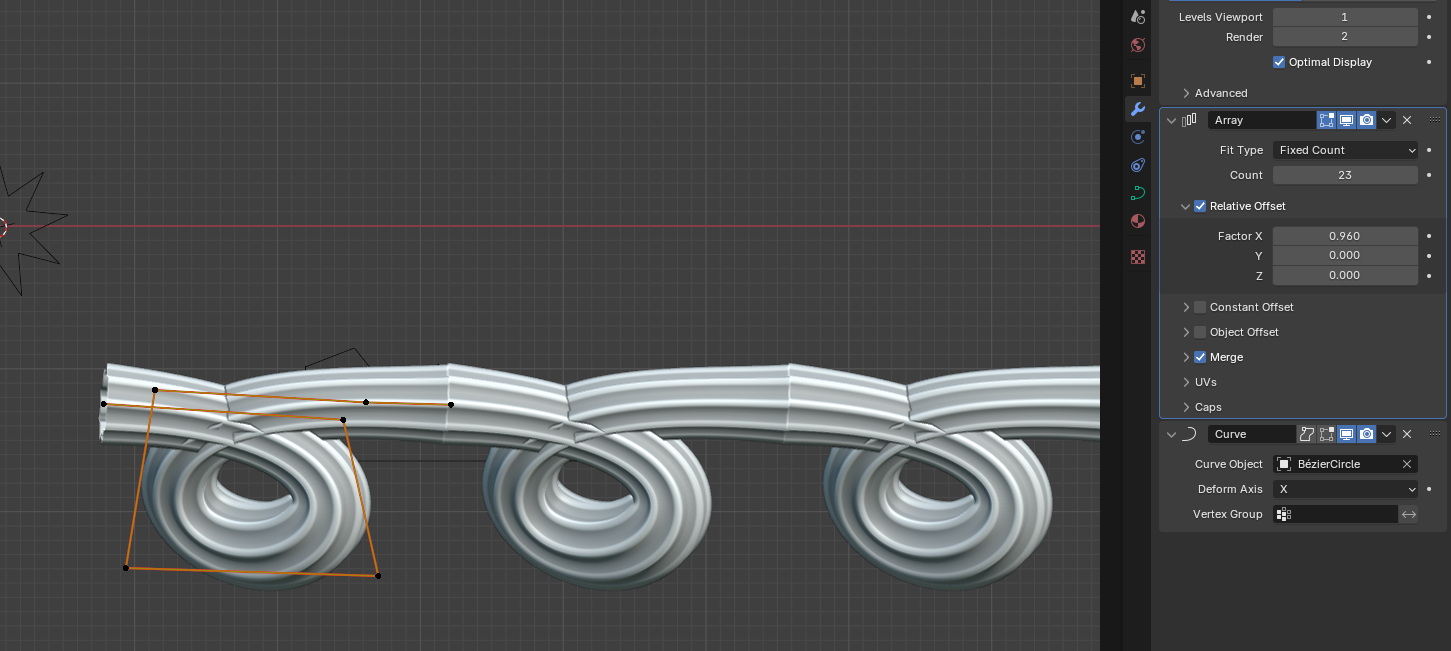

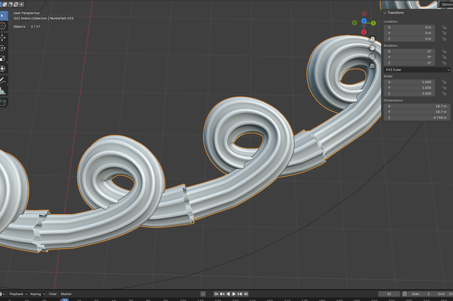

      I used array and curve to fit circle shape, is it possible to connect them between  space gaps
      #90741
        Yes, you can get rid of those gaps, if I understand you correctly. You just have to make sure the object you are using starts the same way as it finishes, so the beginning and end match and you get rid of the gap. Objects that have to follow along curves can get tricky. So if you can’t get around on solving it, maybe you can post screenshots and describe the situation a bit more so we have more context to determine what is happening.

          I tried different values, different scales, if to rotate, then the shape changes where i wouldn’t like to see changes

              Perhaps if you enable the “Merge” option in the Array modifier, it will merge the vertices and get rid of the gap. Try that.

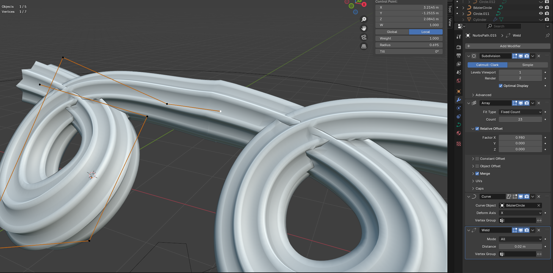

                Yes, but I think you’ll have to manually tweak the ends of the curly curves in Edit Mode, to make them fit as closely as possible and add a Weld Modifier at the end of your Modifier Stack to Merge them.

                    Using weld, helped to merge, but merged all others parts

                        You can also Scale the Radius (with ALT+S) of the endpoints of the Curve, to get a better match.

                              Trying my best😅, it started looks like almost alike and in some points merges but in some plaes still left unmerged parts
