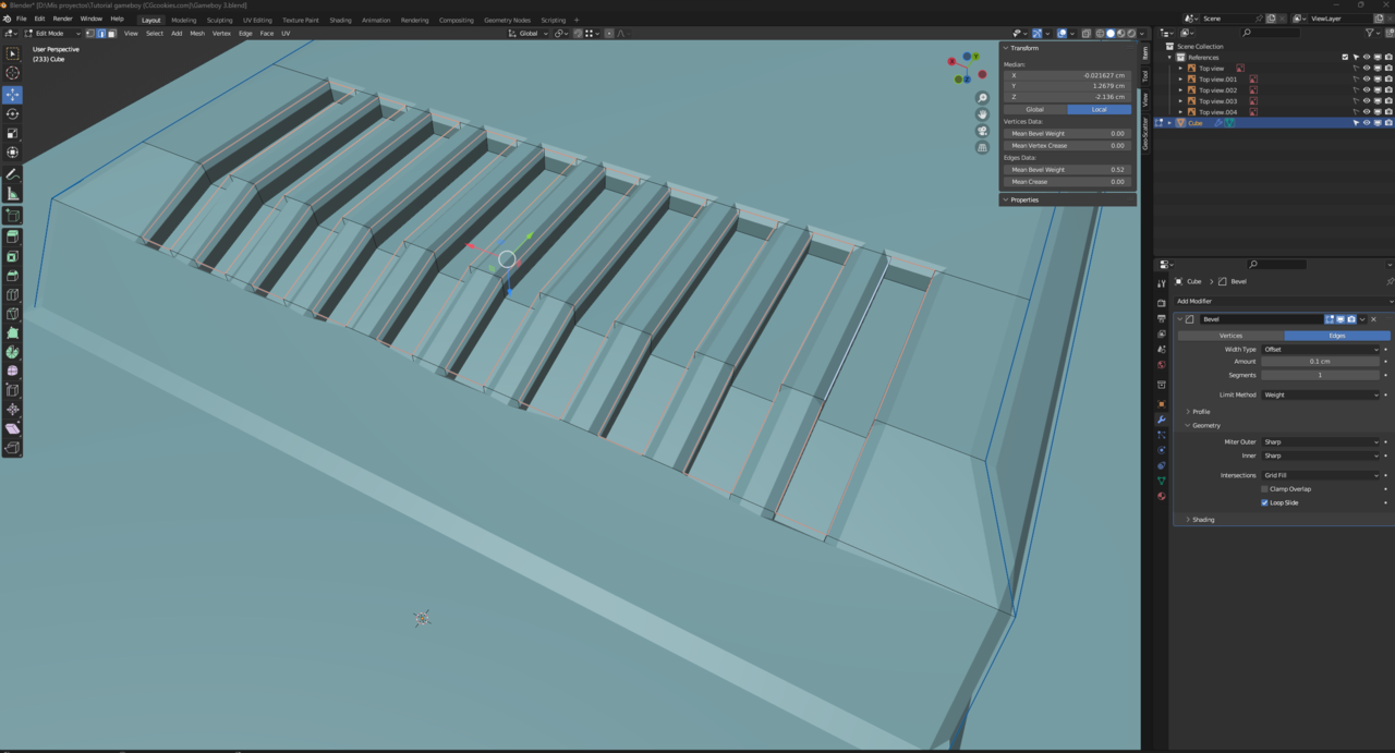

      Hi, When i do the bevel by selecting the loops i have an issue in the low part…. Can you help me with this?

          The typical offenders are:
          Have you applied the scale on your object?
          Remove doubles. In Edit Mode, select everything with A and M to merge by distance
          Flipped normals. Check if you have flipped faces. In the overlays you can turn on Face Orientation and if you see a red face, then in edit mode select everything and Shift + N to recalculate the normals
          Check for interior faces or ripped vertices.
          Also the angle of the face can be off. That is a tricky one and we can jump into that if non of the above work.

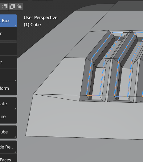

            Check the points Omar mentioned, but I think the main problem is the last one; when I look at the shading of your Faces, there appears to be an angle here:

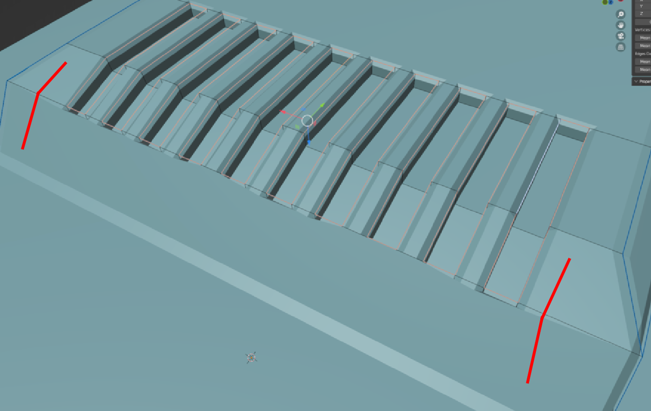

              You are right, I also have that issue. So.. how to remove this angle? Because it is caused by the mean bevel weight. Anybody got an idea? And how come the instructor doesn’t have this issue in the video? Thanks

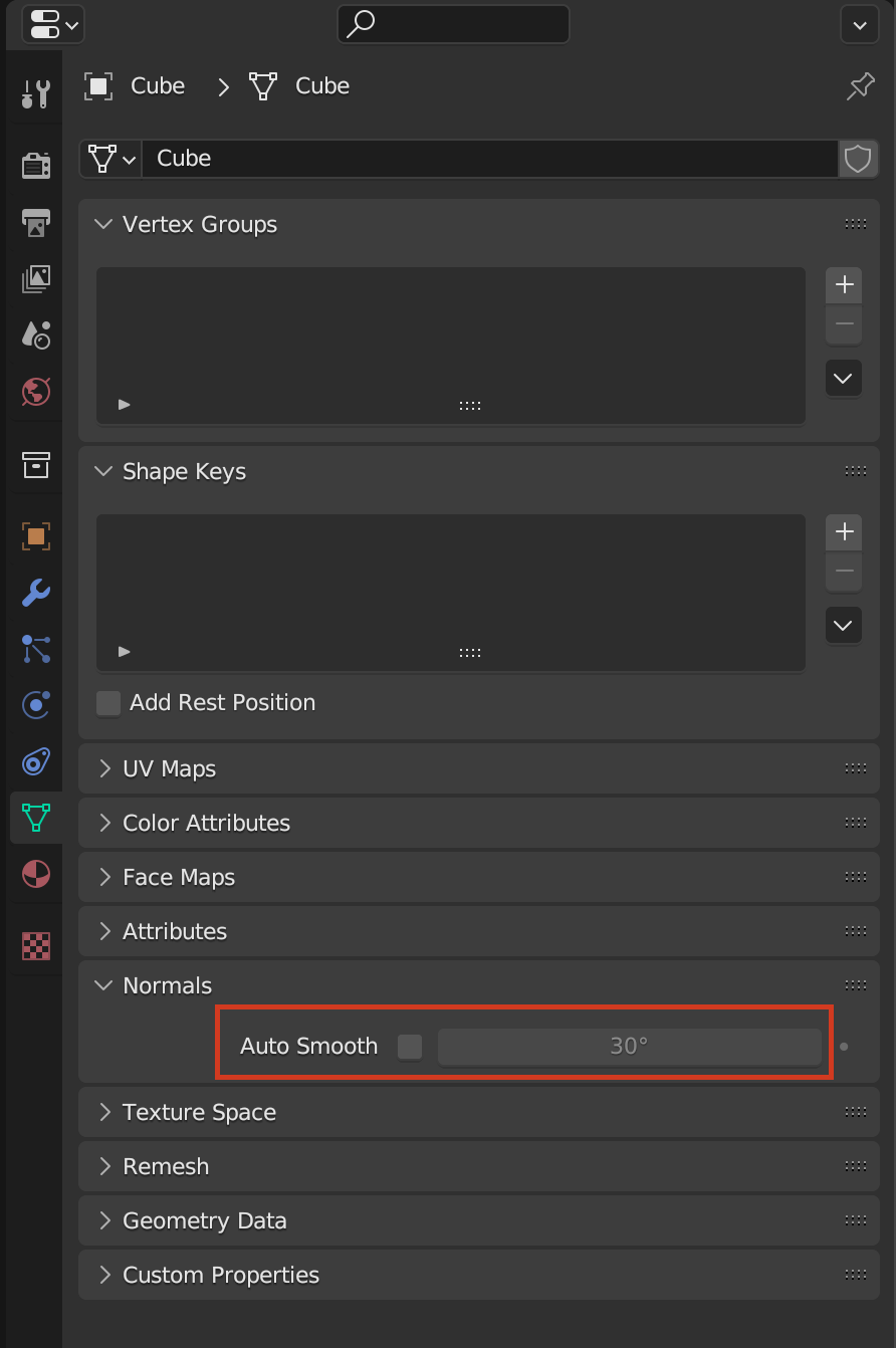

                  In the normals auto smooth, you can try lowering the angle threshold. Or you can try changing the angle in the geometry itself. So select all the top vertices and lower everything a bit. Or maybe elongate in Y the whole back structure. The point is to change the angle there so it readjusts.
                  It doesn’t happen to the teacher because he modeled it differently where the angle was just right for the smoothing. But it could’ve have happened to him and if it did he would adjust things until it was just right.

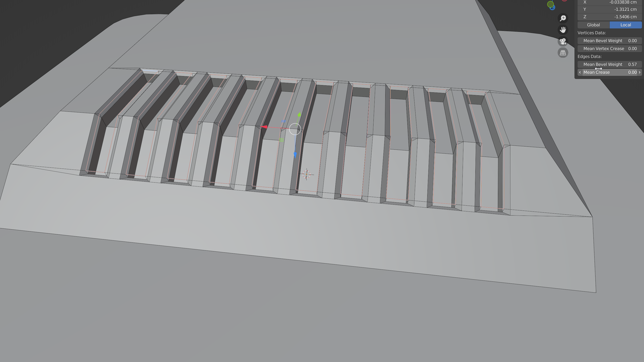

                              Hey Marcel @Artmhdesign ,
                              I don’t see any issue with your model, it looks great to me:
                              What exactly would you like to see changed?
                              #79180
                              Marcel Hoekstra
                                Thanks, but the mean bevel weight adjustment makes the bevel ánd is making an angle (the lower horizontal line)
                                #79181
                                Marcel Hoekstra
                                  when I make the mean bevel weight 1.00 u see better what I mean:
