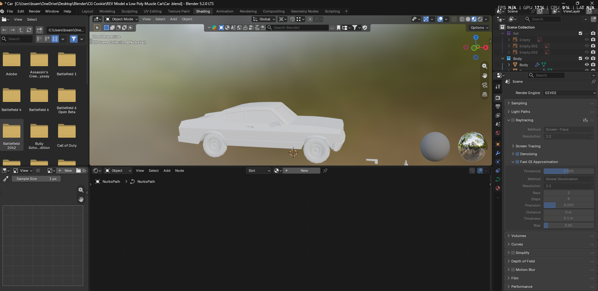

      Hi, I’m using Blender 5.2 LTS, but I can’t find the Ambient Occlusion option under Eevee’s Render Properties like you have in the course. Has it been removed or moved in the newer version? If so, what should I use instead?
      #101099
      Dwayne Savage
        Eevee was rewritten and now has the option to turn on raytracing and doesn’t have to fake AO.
        #101100
          Well actually,
          It’s hidden here:
          #101101
          Dwayne Savage
            Oops. Well I learned something new. Thanks for the correction and info @spikeyxxx
            #101102
              Although, isn’t it better to leave it at GI instead of changing it to AO? Because the GI will include the AO?
