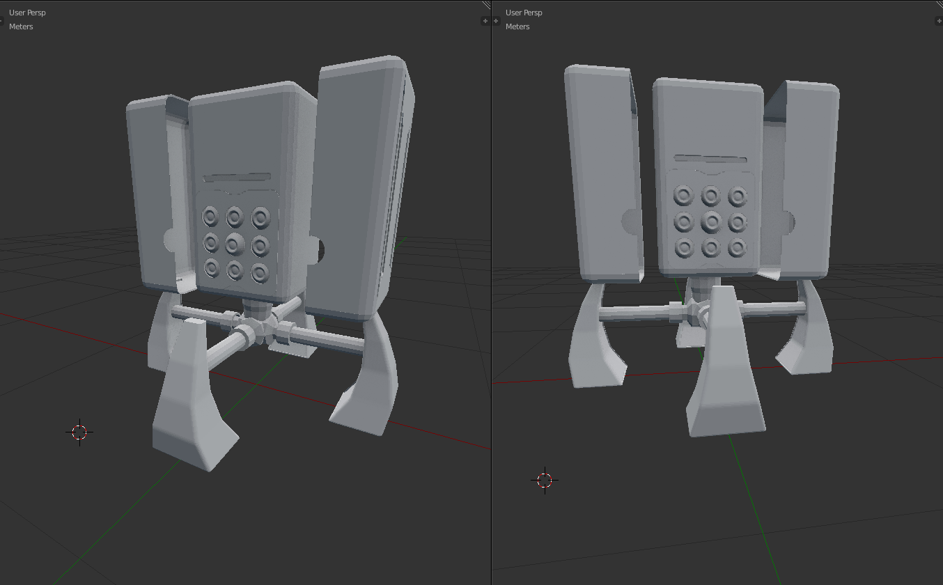

      So i recently started doing more work with Blender, and i just finished this model today:
      i wanted to texture it but there is really something bothering me about rigging and animation, because at the end am learning 3D to use it in games, and animation is a must-have skill.
      That’s why i set a “mini” goal that in the next 3 month, i should be able to make a game similar to the “Last Invader“, code wise the game is really easy to make, the real challenge for me is gonna be the creation of the assets, most importantly the animation and the workflow between Blender & Unity for that matter,

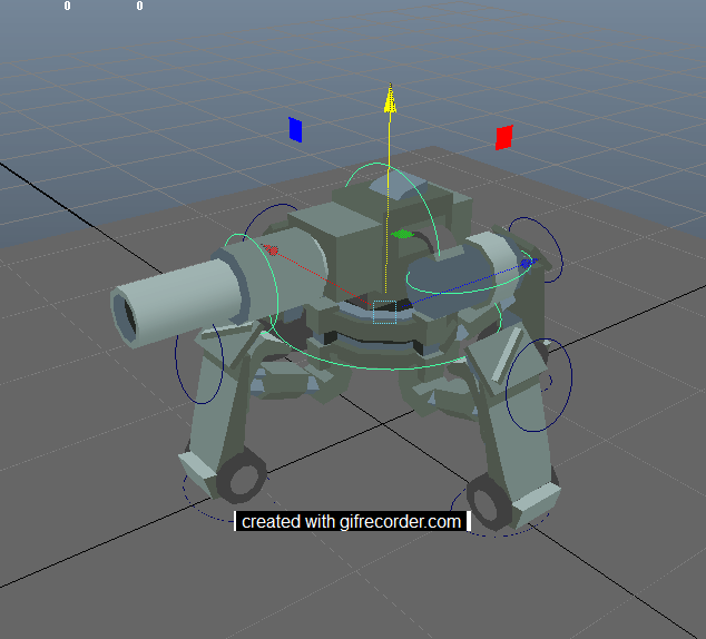

      At the moment am worrying about what Rigging Technics should i use, i started watching the “Fundamentals of Rigging in Blender” Course and the first chapter is called “Mechanical Rigging” which make perfect sense for the robot game am making, however, in that method they don’t use Bones at all, its all made with “Empties” and a bunch of Constraints, my main concern now is if that “Empty+Constraint” animation made in Blender will work in Unity or not, i even checked the Art Station of the Creator of the Last invader game, and he used the same Technic (no bones) but in Maya not Blender:
      Am wondering if that will works, i also want to know if an no-bones rig will allow some coding to effect the animation ? for example if i re-create that “legged tank” model, its “feet” should animate based on the blender animation, but the top part should follow wherever the player is aiming at, will that be possible ?

        Creating something like that would probably require general IK to be used. Alan Zucconi has a good series on the topic using robot arms but it’s definitely more complex than using the built in humanoid IK system. I’m not sure if it would look as good as what you have in the gif but that’s what comes to mind. Other than that, if you didn’t want to use IK maybe some fancy timing of the animations in conjunction with some scripted events would work. It’s more limited, but it may look better as well.
        As far as the 3d workflow it’ll be fairly easy to get up to speed. Since you’ve been using Unity for a while now it’s mostly just getting used to working with 3d objects and a 3d environment but a lot of stuff you’ve used in 2D also has an equivalent in 3D as well.
        In the past constraints from Blender didn’t transfer over well to Unity, but I did notice a checkbox for constraints under the animations section in the inspector recently.
         I don’t know if that’s always been there but I noticed it recently so maybe try importing your rig with the constraints as is and see if it works. IK probably wouldn’t transfer over but at least you can see if your rig needs to be modified.

            @alaslipknot You can keep the bones in to play the animations. You can play animations and also control parts of the mesh by using avatar masks. The link I provided demonstrates how it works with a human character but with a generic rig like you  have, you’d have to specify the transforms that you want to block out from playing animations.
             So with a human you get a fancy human layout to create your mask, but with a generic rig it just gives you a list of transforms you can use.  I’ve never used them in a real time manner, but I have used them to block out parts of a rig that I want to exclude from animations.
            Regarding the rigging, it’s usually easier to animate an object when it has a rig but you can also keyframe everything by hand and moving everything around. Rigging just makes it easier since you can move a lot of things simultaneously.
            A rigging for games course is something I’ve personally wanted to see as well. Rigging in Blender can be a bit complex and sometimes it doesn’t always transfer over well to games. Rigging isn’t something I’m great at, but I understand the process.
            If you have any specific ideas of what you’re trying to accomplish let me know. It’s a bit tough to give you real advice without knowing exactly what you’re trying to achieve. This is where I’d start first:
            • Import the model into Unity
            • Use Mecanim and an Animator Controller for a basic idle animation state
            • Add a second animation state you can transition to (like a fighting animation)
            • Add in a avatar mask to block out a part of the robot like the head or legs
            Once you know how to do that you can expand upon it. If you have any other questions let me know.
