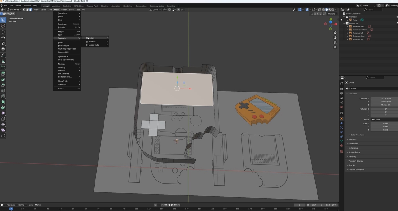

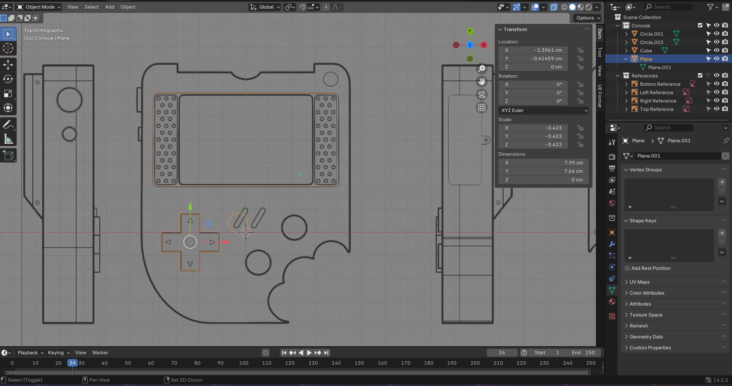

      Not sure how I fell into this one. Everything was being added as an individual object at first. I added the direction bad, then moved to the screen then the two middle buttons. I went to move these in object individually but didn’t see them in the collection screen as separate objects. Further investigation shows them all part of my plane, the first one being direction pad. I don’t see them as individual mesh data either
      So 2 questions.
      How do I separate these back out? ( I know I can easily remake them, but what if it happens again?)
      How did I do it in the first place?
      I’m pretty sure I didnt accidently parent them.
      #90646
      Al Mar
        After looking into it further, I guess I was using shift+a to add more meshes while already in edit mode. This keeps adding meshes without an object container in the collection since I wasn’t in object mode > add mesh.
        Still curious how to separate them back out to their own though

            #90649
            Al Mar
              Thanks for the replies. Based on what I’m seeing so far and in some google searches, this isn’t something blender has been designed to do yet.
              I tried to select both buttons and used Mesh > Separate > Selection as suggested above.
              It creaded a separate separate object, but in the original object, both meshes stay there, and it created a circle mesh with just an orgin point in the new one.
              I’m pretty sure the tutorial has all the meshes within the main “cube” object anyway, So i’m going to go back and redo everything incase that presents problems later.
