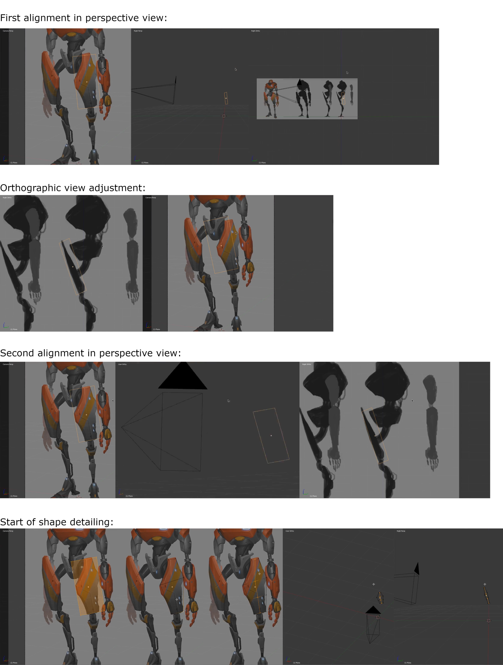

      I have difficulties to sufficiently accurately align the first panel in perspective camera view and in orthographic right side view:
      Link to my file:
      https://www.dropbox.com/s/r1dq7r1d90q86ue/GameCharacterModeling_Trammell_16April2020_3.blend?dl=0

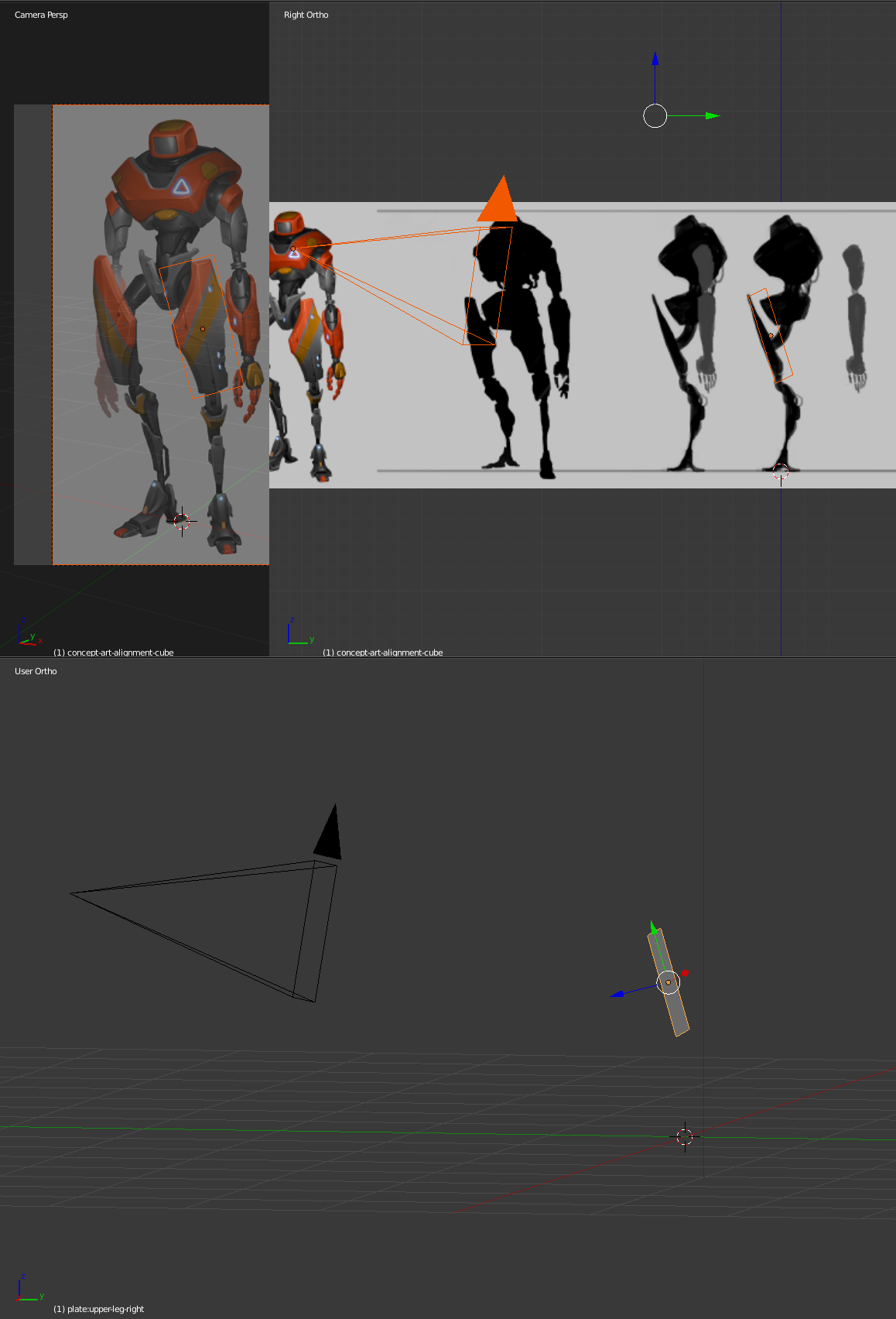

        I think that what is tripping you up is the fact that the right orthographic view only shows the right leg!
        And that not even super accurate compared to the camera view;)
        Just looking at those pictures above, I’d read the two plates something like this:
        Look at the feet in camera view to get an idea how the legs are positioned and rotated..
        But I’m sure that Kent explains it all if you keep following along. (I didn’t take this course yet, still on my- getting longer everyday- todo list…)

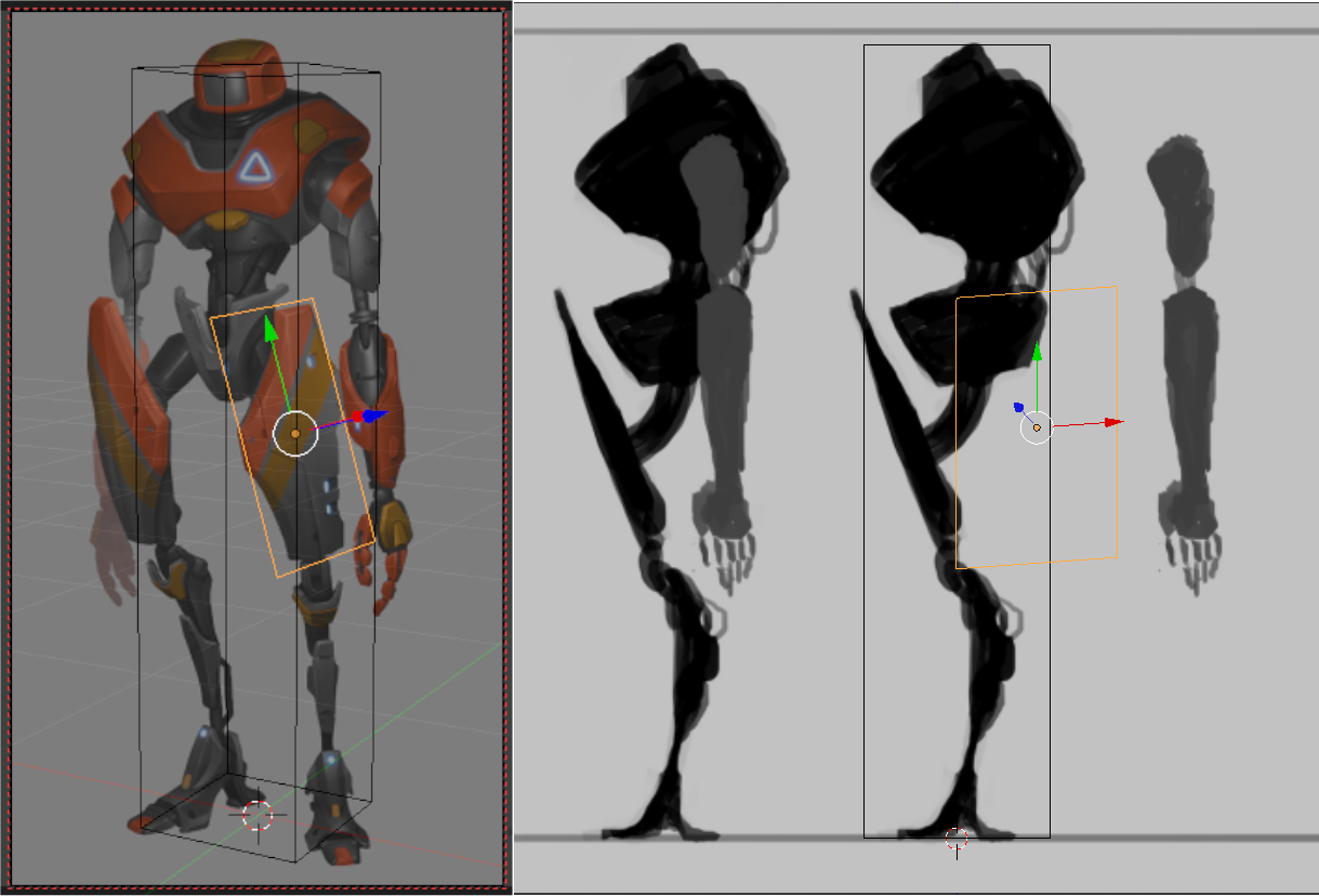

            That’s how Kent did it:
            The plate seems to be tilted downwards like in orthographic right side view (according to Blender’s terminology, but which is essentially the character’s left side), whereas the perspective artwork rather lets me think at a plate that is tilted upwards (look at the shading which seems to be brighter in the upper part of the plate).

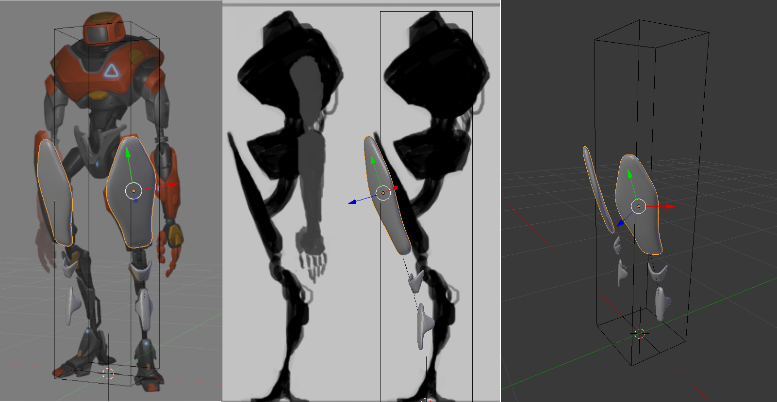

              And this my newest attempt:
              #55932
                Looks like you’re on the right track! Keep in mind it will never be 100% consistent between an concept artist’s 3/4 view and side view. This is where you must develop your visual translation skills, which you seem to be doing quite well 👍

                              So, this is the best compromise I can currently imagine between camera perspective, right side orthographic and free perspective view outside the camera:
                              I’ve followed your advice, Kent, to move the leg along the “View” z-axis in order to get the thighs approximatively aligned with the 3/4 view drawing and an active “Mirror Modifier”. I’ve also readjusted the camera view a little bit with the camera locked to the view. The thigh inclination is directed downwards and follows that of the robot’s right side (left image half), the inclination of the shin follows that of the 3/4 view robot’s left leg (right image half) in order to get a more dynamic pose and avoid the right side orthographic view’s leanback. If there’re no major concerns from your side, Kent and Spikey, I’ll continue now with the blocking of the leg behind the shields.
                              PS: A link to my current file is here.
                              #55940
                                You’re compromising like a pro! The thigh pieces look great imo. Since the 3/4 view is usually the most appealing view of a concept character, it’s best that your pieces favor it. The fact that it looks most different from the side ortho is the right call imo.
                                While I probably wouldn’t have opted for the shin placement as you have, your choice is valid and I think you should continue the way you have it. Some of the details from the side you’ll have to eye-ball since your robot’s right leg will be significantly off the mark in the 3/4 view. But you can always change the orientation later if it’s a problem.
                                Keep up the good work, Ingmar!
