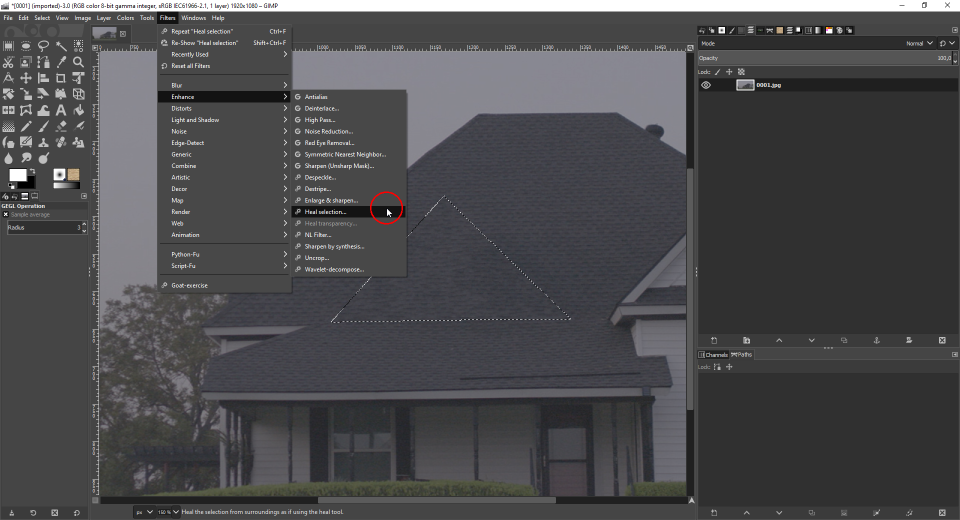

      With the “Heal Selection Filter” in “Gimp”, I could create a continuous shingle roof needed for texturing the fractured roof parts:
