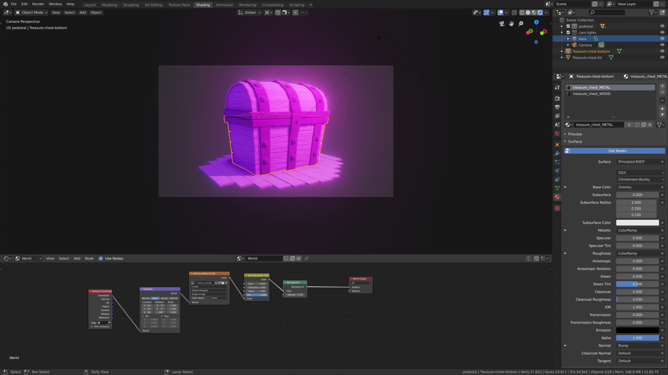

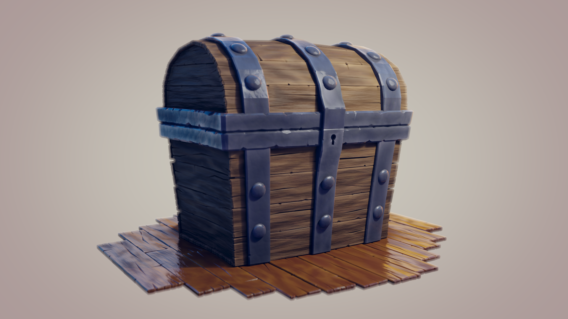

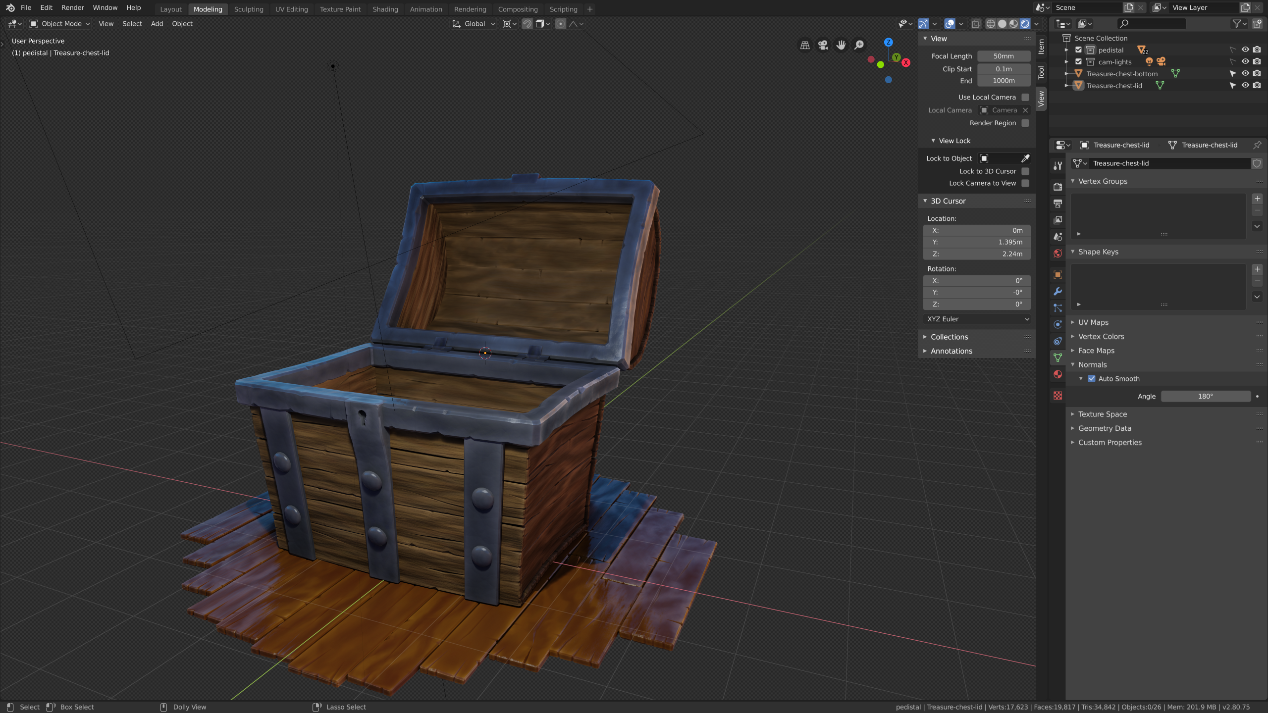

      I was about to start the coin simulation part and I saved, closed blender, and reopened it only to find everything is pink now. The first two images are prior to closing and the pink one is right after reopening the file. Did I lose a texture file somewhere or can anyone point out what I’m missing here?
