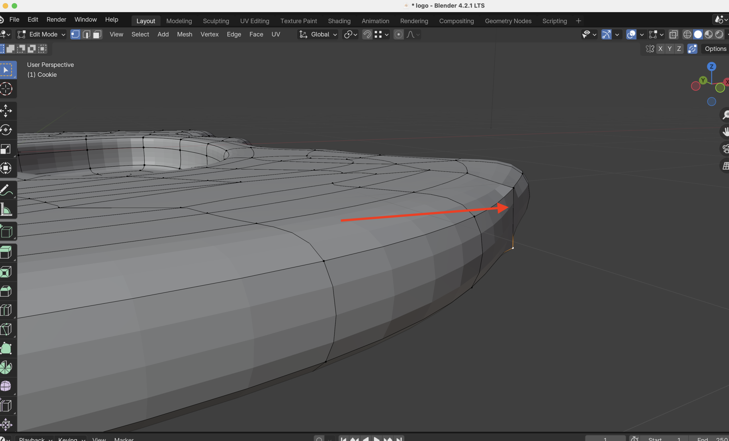

After extruding, two random edge on the outer circle are straight instead curved
Forum Archive After extruding, two random edge on the outer circle are straight instead curved
  • #18867
    rafael marcus
      How do i fix this?
      #89955
        Looks like you have double vertices there. Maybe at some point you extruded and undo but didn’t go enough back, so now you have bunched up geometry there and it is pinching. So select everything and M to merge by distance.
