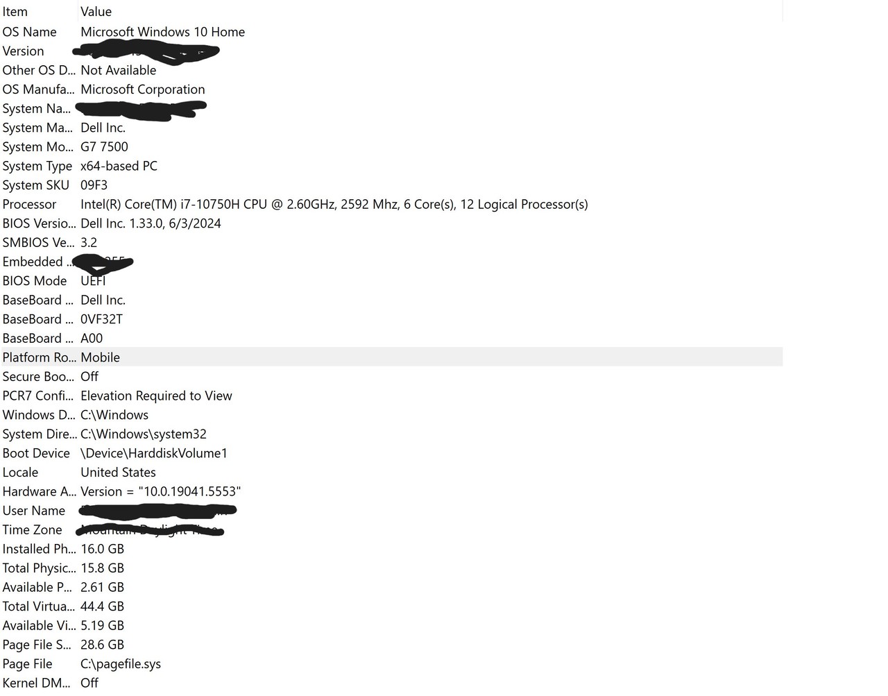

          If my computer may not support it, I may consider getting new hardware/computer. The projects I create are heavy in graphics. Let me know though. Thank you!

            I hate to say it, but looking at your specs I’d almost assume it’s the computer. Laptops are generally not the best for Blender. The specs don’t mention a dedicated gpu, so I’m guessing it’s all through the cpu graphics? That’ll slow things down fast. Also 16GB RAM is not a whole lot for modern versions either.

                      The main problem I see is the memory. Your Available Physical Memory is only 2.61GB at the time you ran System Info. Your file loads up with 0.78GB. Depending on what you do the Undo can easily double that in just a few changes. If you just switch to material preview or render view that jumps to over 2.3GB. This means your system will start using Virtual memory which it’s already using 38+GB with 28+GB in the slower page file. As for dream 10 file, it has 1 million faces more than dream 7. Both of them have 220 material slots that aren’t being used. You can free up memory by closing down other programs and background processes. Vertex groups can slowdown system with slower CPUs, but yours should be able to handle it.
