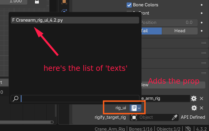

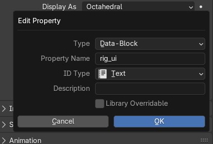

          B
          If you are appending the Wrangler and the UI isn’t coming along, you need to attach it to the rig with the data_block property.
          First add a custom property
          Type: Data-Block
          ID Type: Text
          Property Name: something logical
          Then you will see that custom property on the armature data (where you create it)
          Choose the ui script from the pop up.
          Then the script will always follow along with your rig into any file.
