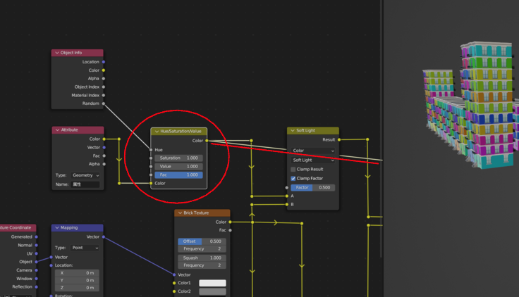

      Hello, teacher, after following your method, the color of each layer of mine is different? Also, why can’t I upload pictures here?
      #87918
      凯 胡
        Okay, as shown in the picture

          Adrian Bellworthy
            Without seeing more of the shader I can’t give an exact answer.
            But I’m guessing, looking at your neat network of noodles, there is one that stands out to me and probably the culprit.
            If that noodle is plugged into the output node, then all you are seeing is the random color plugged into the HSV node through the output.

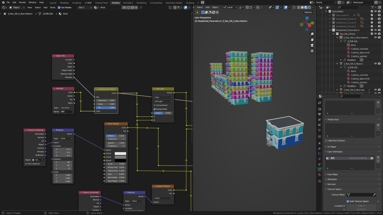

            凯 胡
              Teacher, can you see this picture clearly?

                #87923
                  Hii @Cash_Hoo ,
                  Having a look at your .blend would be better; I, for one, cannot read the Nodes and I have a suspicion, that the mistake is not in the Node tree itself…

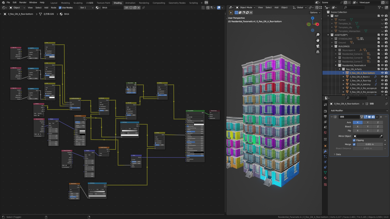

                    Sorry, missed that last answer
                    Can you upload it to Dropbox, Googledrive or so and post a link here?
                    #87925
                      Oh wait!
                      Can you go back two Lessons to the Gradient Fix Lesson….make sure you are using that, because I think that was the issue with the other person that had this problem…
                      #87926
                      凯 胡
                        Oh, it seems so. Since the gradient repair class was a bit difficult, I skipped it directly.
