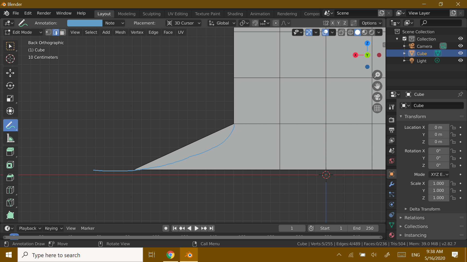

      # third, on the attached image, I selected the bottom edges and moved them (grab) forward to create a slope. How would I be able to smooth out the slope so it is more of a curve, like a wave form, as annotated in the image.

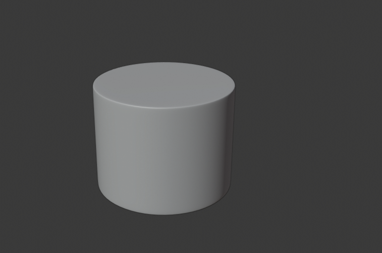

        2.How  to make a cylinder out of a cube? Usually, there are many ways to create an object in Blender. I’d go that way:

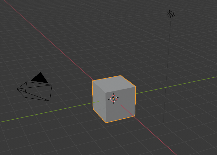

        a) Basic scene -> Select Cube, Tab into Edit Mode / Ctrl-R to add geometry:
        b) Scale edges (do not forget to press Shift-Z to cancel Z-axis scaling, you need that to keep it flat):

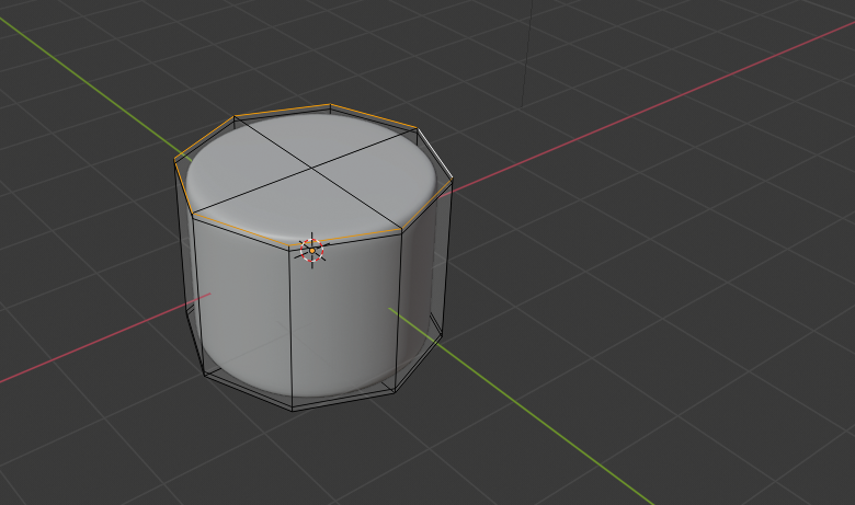

        c) Use Sub-Surf to refine the form (Add Modifier/Sub Surf), then add two more edge-loops to support top/bottom rims:

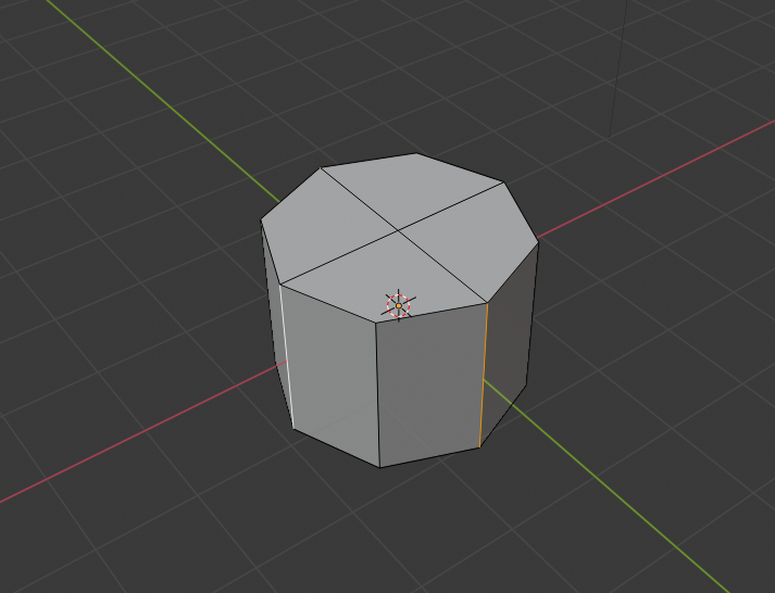

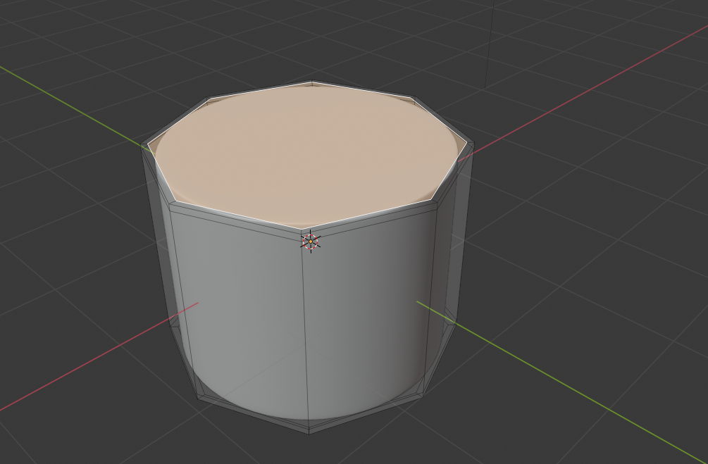

        e) Then remove that central vertex (both top and bottom), fill the gap, press “I” to Inset faces. Just like that:
        d) You can also remove that n-gone faces and replace them with quads (use Grid-fill option).
        3. There are two ways basically. Add more geometry then Smooth it (Object / Shade Smooth). Use modifiers.
        I’d go modifiers to keep the original form as simple as possible.
