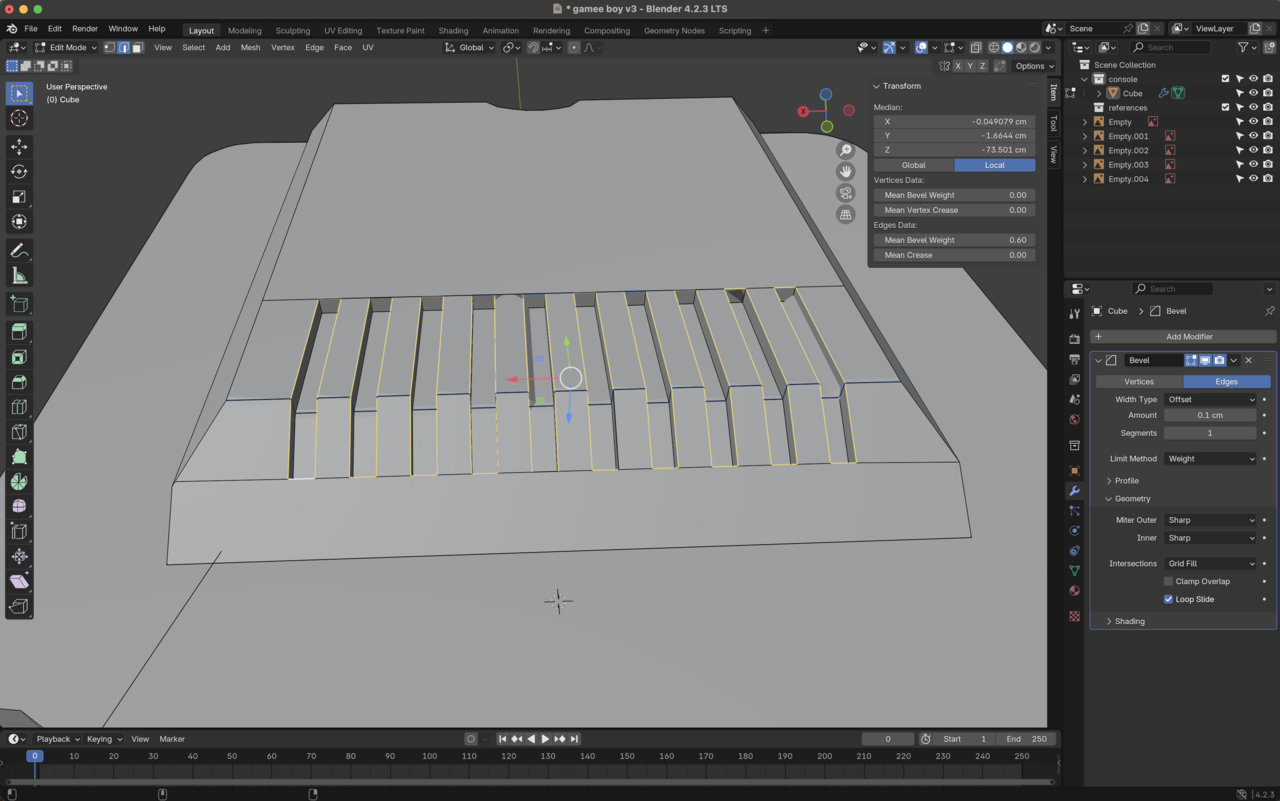

      I need Help objects half of the time don’t want to bevel on my project

        this are the screen of my labtop

          Hi Alexandre @Alex123666 ,
          Disable the Clamp Overlap in the Bevel Modifier (under Geometry).
          #92059
            Also make sure that the Scale of your Objects is Applied (in Object Mode: CTRL+A > Apply > Scale).
            #92060
            Leo
              It is also possible that the normals are misaligned.
              I would check once via Face Orientation. If the faces are red, you have to flip them once with Alt + N
                #92062
                Alexandre Chevalier
                  #92063
                  Sascha Feider
                    Looks like you have a bunch of overlapping faces (the red specks in the second image) and on the far right indent something is very wrong with the faces where you can’t see the lower edge. You definitely have some double vertices, possibly happened during an extrude operation. In edit mode switch to vertex mode -> A to select everything -> M -> Merge by distance.
                    Looking at some of the faces and edges though, this might not solve all your problems. In that case your best bet would probably be to start and redo this section over from scratch.
                    #92064
                      Starting this part over is definitely the best thing you can do; there appears to be quite a few things wrong with your Geometry, but I can’t tell what exactly, from the screenshots.
