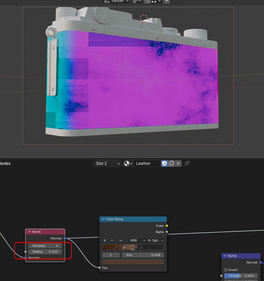

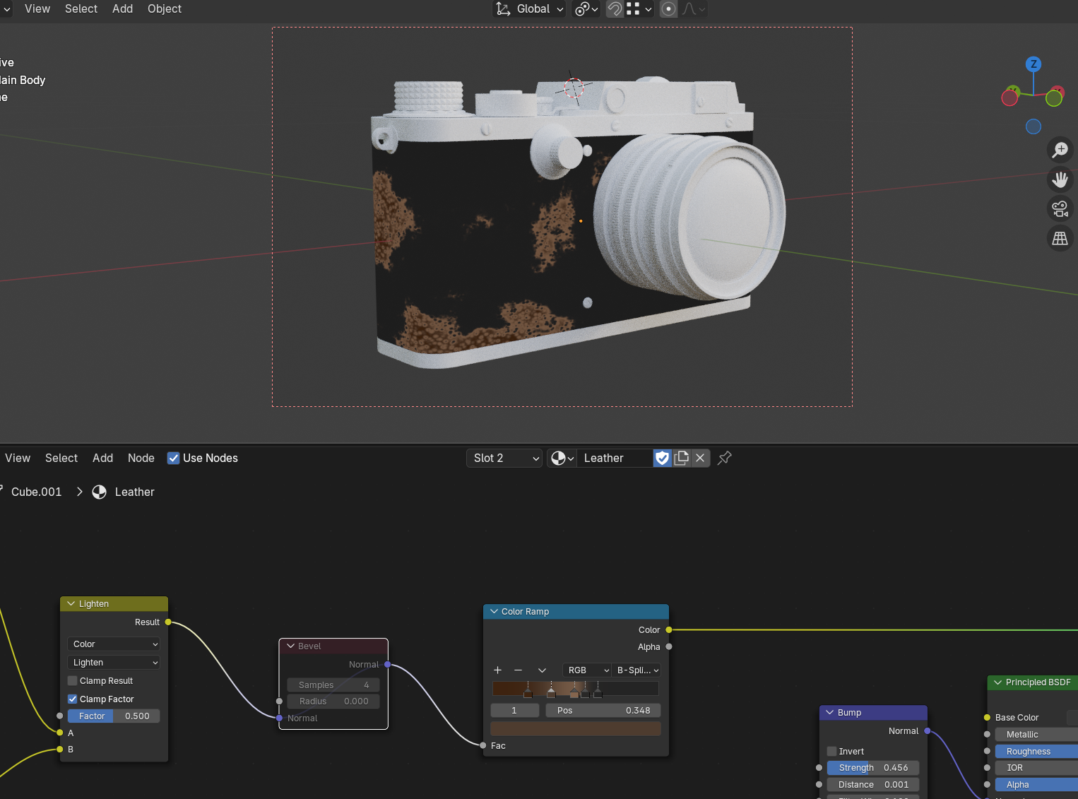

      Was all going fine and then hit a wall once I added Bevel node. Why isn’t it working as expected?

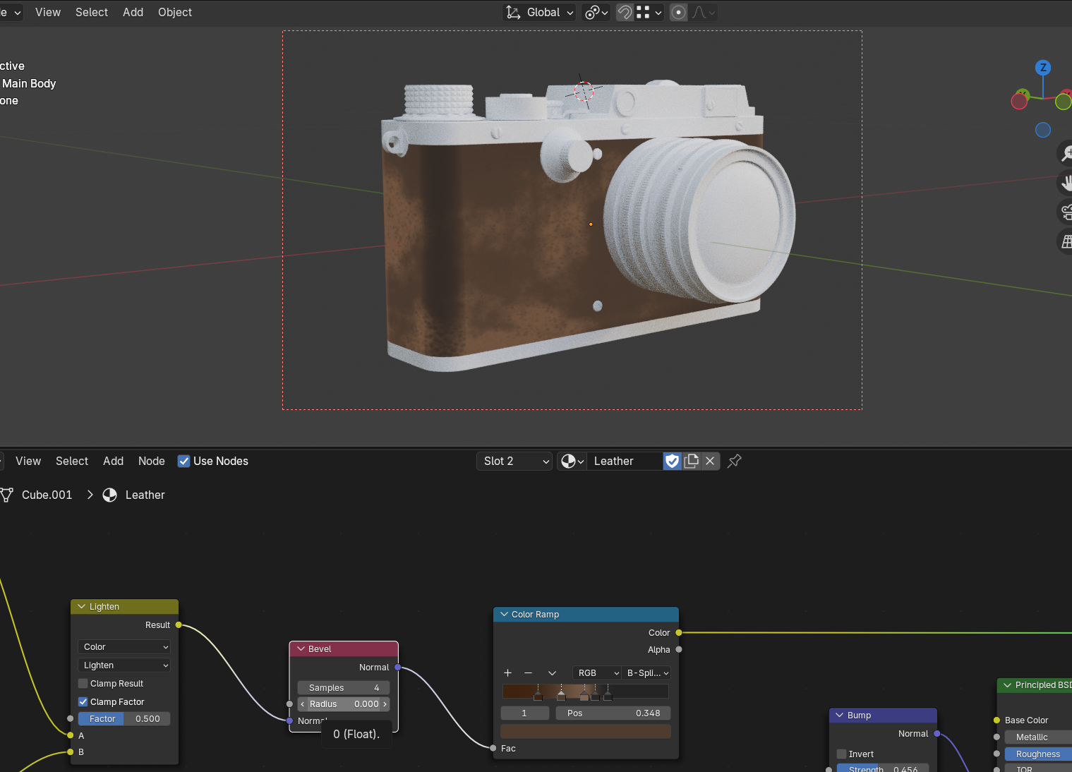

      Bevel muted so you can see all good up to this point

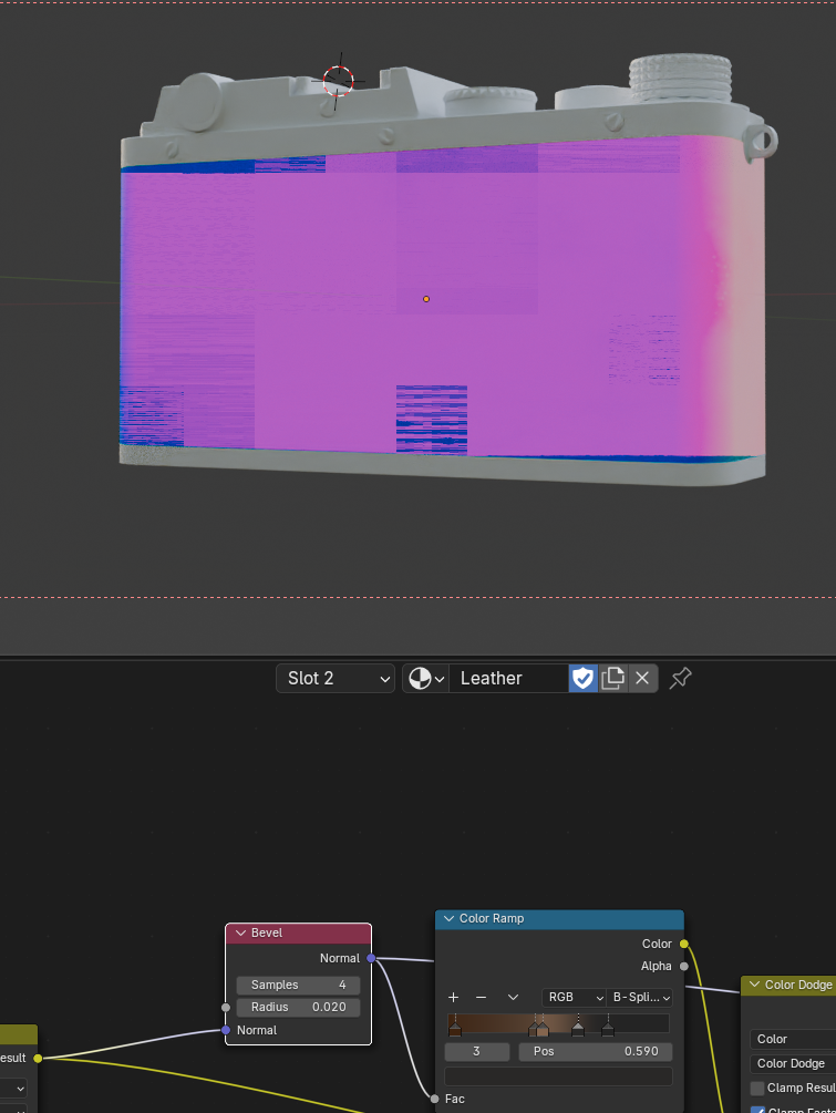

      When I add the bevel is doesn’t matter what setting I use it stays exactly the same.Transformations applied.

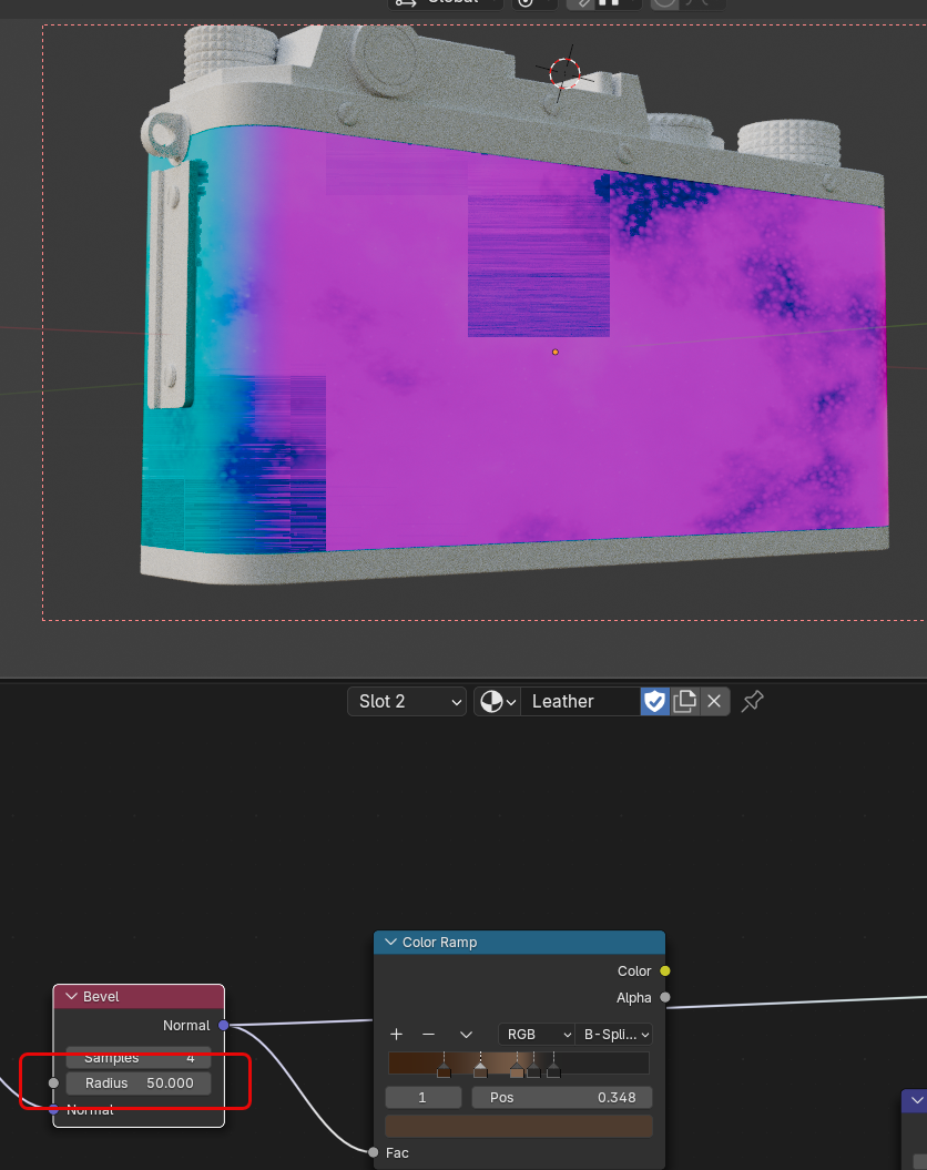

      Bevel unmeted: radius 0
      Bevel radius 50 – no change
      also the bevel only affects this one corner. Why not the others?
      if I preview the bevel node I get glitchy results but it does show a different glitch for different radius values

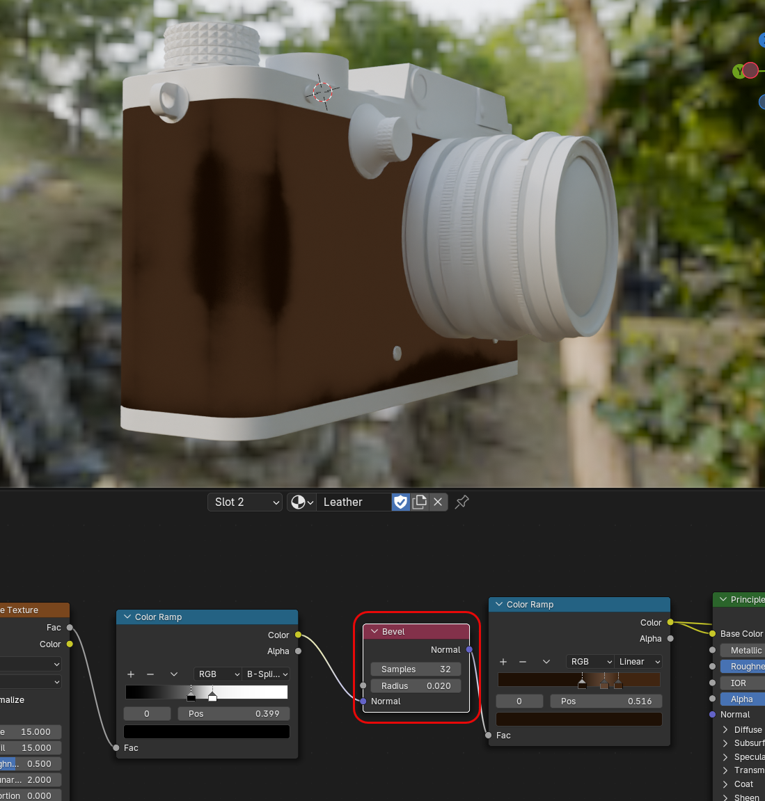

        Bevel node goes into the normal input of your shader Node(Usually principle shader or the displacement of the material output Node). You have it going into the color ramp. Also Bevel node only works in Cycles renders.
        #98695
          Also,
          I am pretty sure, that the Radius is measured in Meters, so unless you’re making a gigantic Camera, 5.1 and 50 are absurd values.

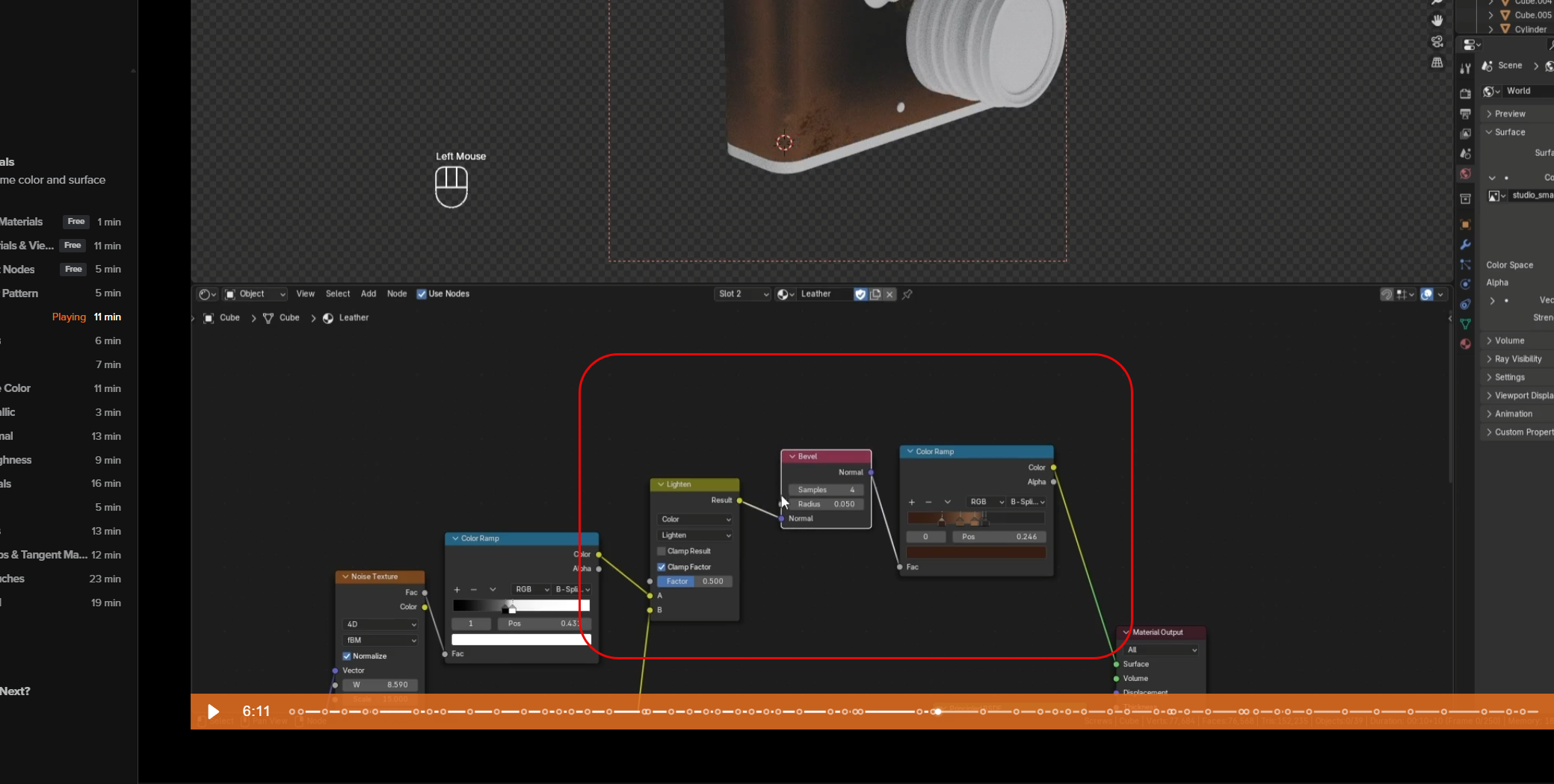

            Dwayne. Bevel to Colour Ramp is exactly what Ewa does.
            Martin – values were to show that radius is having no effect that’s why I used 0 and 50. And for the bevel preview radius values were just to show that the number does seem to be doing ‘something’. I’m still getting the glitch effect when radius is set to .02. I don’t know if the glitch is normal or not. I was just trying stuff cos I don’t understand why it’s not working in the way it does in the video. I’m on 4.5 but can’t think this makes a difference. I can only think there’s something wrong with my model but can’t think what when scale and rotation applied and I’ve checked normal orientation. I’ll do a test on a brand new beveled model and see what happens

                  Martin. I went through the mesh with a fine tooth comb. After a wild goose chase trying to join vertices of the inner extruded edges I rewatched 1.2 BlockOut lesson are realised the mesh is supposed to be separate!

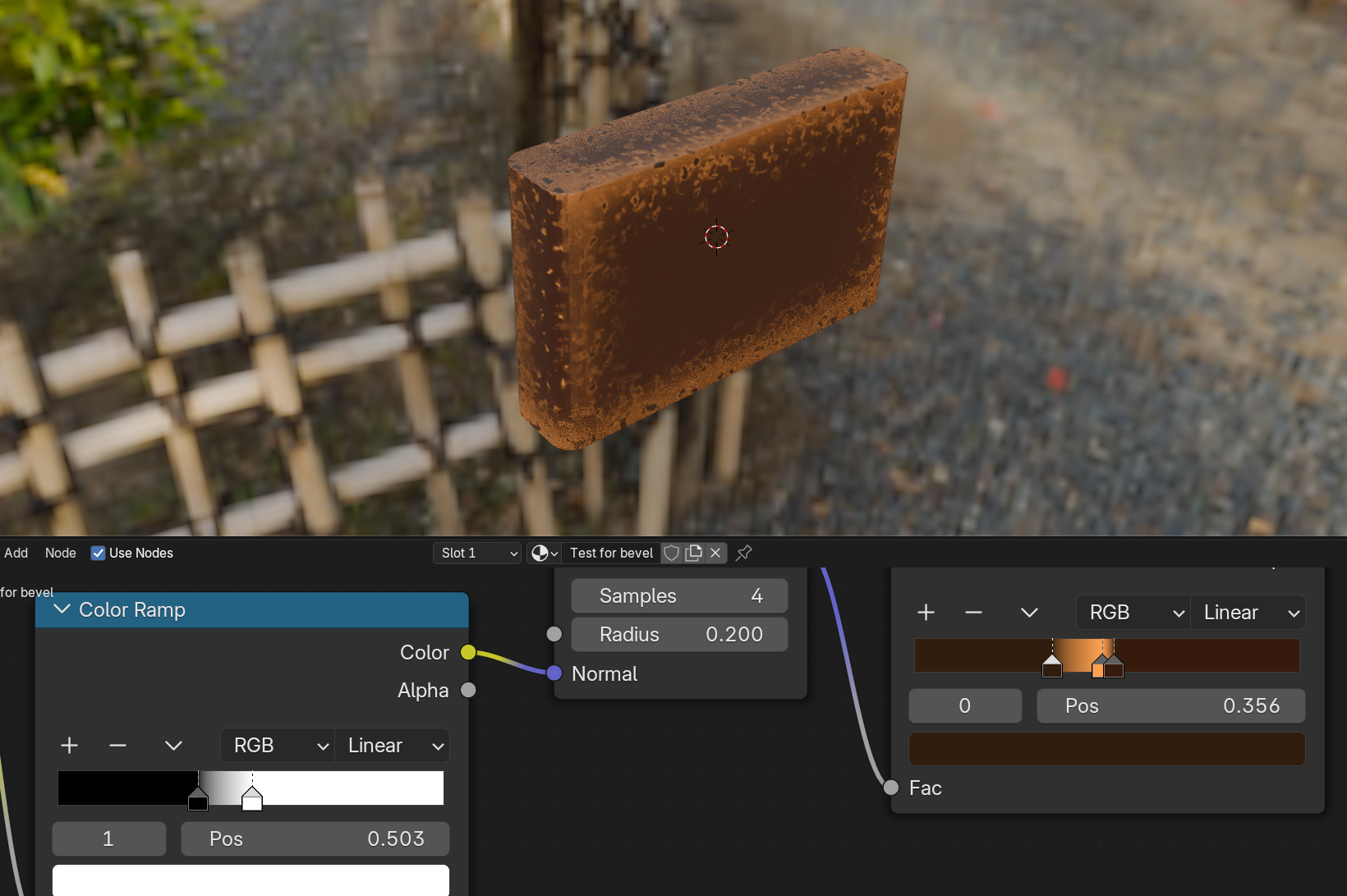

                  However I did find a few edges marked sharp and clearing those and replacing with a bevel weight has allowed the bevel node to work in the sense that different values now produce different results.
                  However it doesn’t feel like a good result. It’s supposed to suggest wear but all it seems to do to my eyes is accentuate the low poly mesh and produce highly unrealistic ‘wear’ on sharp vertical lines on an object that looks smooth.
                  Upping the samples only highlights the issue
                  At least I got to the bottom of it but it’s taken a day to do so 🙁

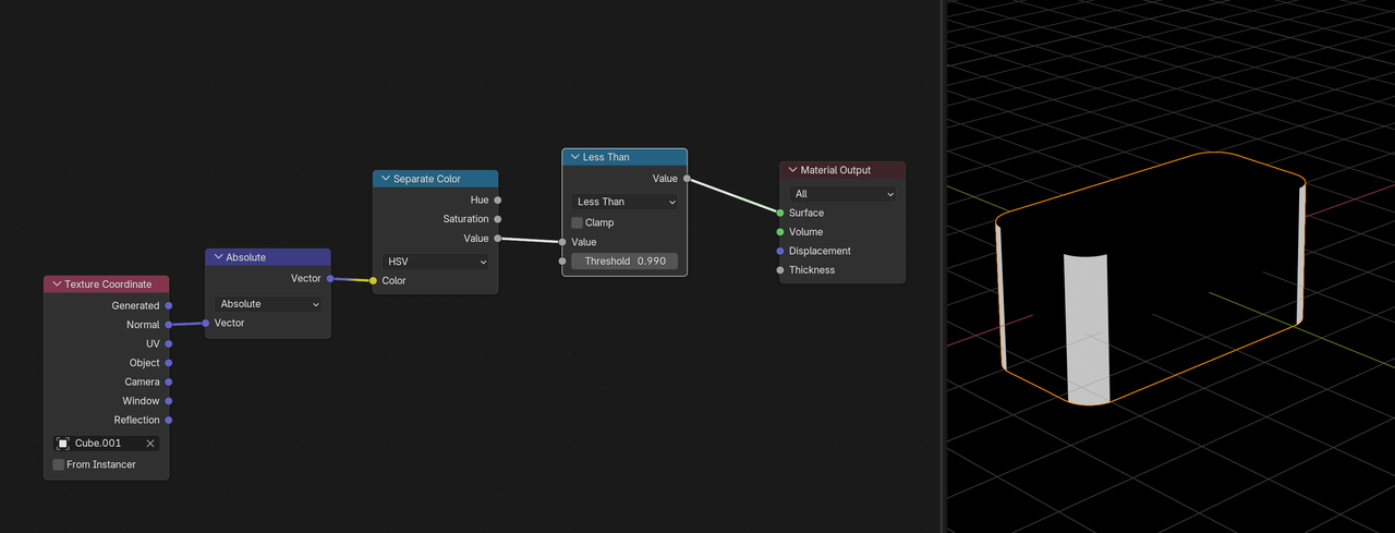

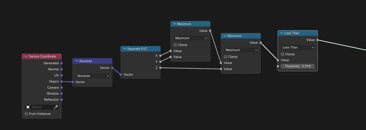

                    For instance, here’s a fun ‘corner Mask’ for a situation like this:
                    The Normals in the Cardinal directions are 1 or -1. The rounded corners have RGB values, all Absolutely less than 1, and the Value of a Color is the Maximum of RGB, so if the Value is Less than 1, the Normal is not in a Cardinal direction.
                    Ordinarily, the Value of a Color is utterly useless, so it’s fun, that we can use it to our advantage here.
                    Combine this with the rest of the techniques instead of the Bevel Node if you feel adventurous. You can always improve on some of the techniques taught in a Tutorial; it is a great base to work from. If you had to do this all from scratch without the Course, it would be extremely difficult.

                        RGB Values in Blender are between 0 and 1.  (Which makes a lot more sense than seeing them as 8-bit values (or even worse, writing those 8 bit values as hexadecimals) and makes calculations a lso a lot easier (for instance 1 times 1 is 1, as opposed to 255 times 255 is 255, but I digress.))
                        Normals are between -1 and 1 (because they are normalized) in blender, If a Normal is  ‘facing’ in the (Object’s Local) positive X-Axis, that means it is the Vector (1, 0, 0).if it is facing in the negative Y-Axis, it is the Vector (0, -1, 0) and so on. The Absolute Value of the Normals that are (anti-)paralel to the (Local) X, Y and Z Axes are (1, 0, 0), (0, 1, 0) and (0, 0, 1). These Vectors can also be read as RGB Values!
                        Any Normal Vector that is not aligned with one  the ‘cardinal directions’, can be written as (x, y, z), where the absolute value of each of the x, y and z is necessarilty smaller than 1 (because the Normals are normalized), so the maximum of the 3 (x, y and z) is also less than 1.
                                “Why do you need colour at all – why can’t you just plug absolute into the Math node?
                        Because the Color can be Separated into HSV and the Value in HSV is the maximum value of R, G and B. So we could also have done something like this:
                        And yes, you are right, Unwrapping and Painting a Mask is a great way to do this. There are always multiple solutions.
                         Think it’s good to know how the Procedural Mask I made works; if nothing else you learned that Blender is not Photoshop and RGB Values are between 0 and 1.

                          Oh, I used Less Than 0.99, but Less Than 1 should work as well, just like Less Than 0.95. It just changes the size of the Mask. You can also plug in a Noise Texture and a Map Range (or Color Ramp) in the Threshold, for instance.
                          #98704
                            Oops forgot a question…
                                 “Is the models colour being turned into white AND black or just one of those? I ask cos it’s only passing through values of less than 0.99 so where’s the info to turn something white and black?”
                            The Less than returns 1 (pure white) if it’s True and 0 (pure black) if it’s False.

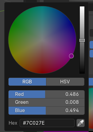

                              And this “Because the Color can be Separated into HSV and the Value in HSV is the maximum value of R, G and B. “
                              So in the example above it compares 0.486, 0.008 & 0.494 and returns 0.494 (the maximum value of the 3) and as that is less than 1 it then turns it white?
                              Presumably  0.486, 0.008 & 0.494 are not from the RGB but from the normal and then used to turn the model white or black with the separate colour node
                              In your 2nd screenshot did you make a mistake with the texture co-ordinate as Object not Normal is plugged into the Absolute node
                              It’s mind boggling how you know all this! I know this is probably simple stuff but it makes my head spin. It’s so much easier when you can just look at stuff and evaluate it!
                              #98706
                                   “255*255=65,025. No?”
                                In normal math, yes, but when you say, that pure red would be written as RGB  (255, 0, 0), then pure red multiplied by pure white (for instance) would be (255*255, 0*255, 0*255), resu;lting in (255, 0, 0). This was just meant to show that having the RGB values going from 0 to 255 really messes up the math.
                                   “In your 2nd screenshot did you make a mistake with the texture co-ordinate as Object not Normal is plugged into the Absolute node.”
                                Indeed, I made a mistake there (i am just so used to using Object Coordinates), that should be the Normal Coordinates.
