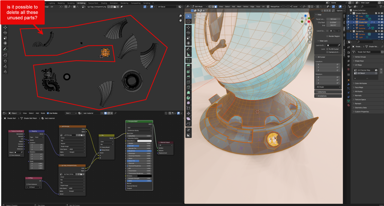

      Happy I got the cookie onto the Shader. My OCD makes me want to tidy up all the unused parts by deleting them. Is it possible?

        As far as I know, you can’t Delete them.
        You can Move them out of the way, or Hide them (in the UV Editor: H to Hide Selected, SHIFT+H to Hide Unselected).

            You could reset them, they will become a square and you can move them out of the way. So that is U and reset.
            #82099
              Or, you can only Unwrap the part of the Mesh that you need.

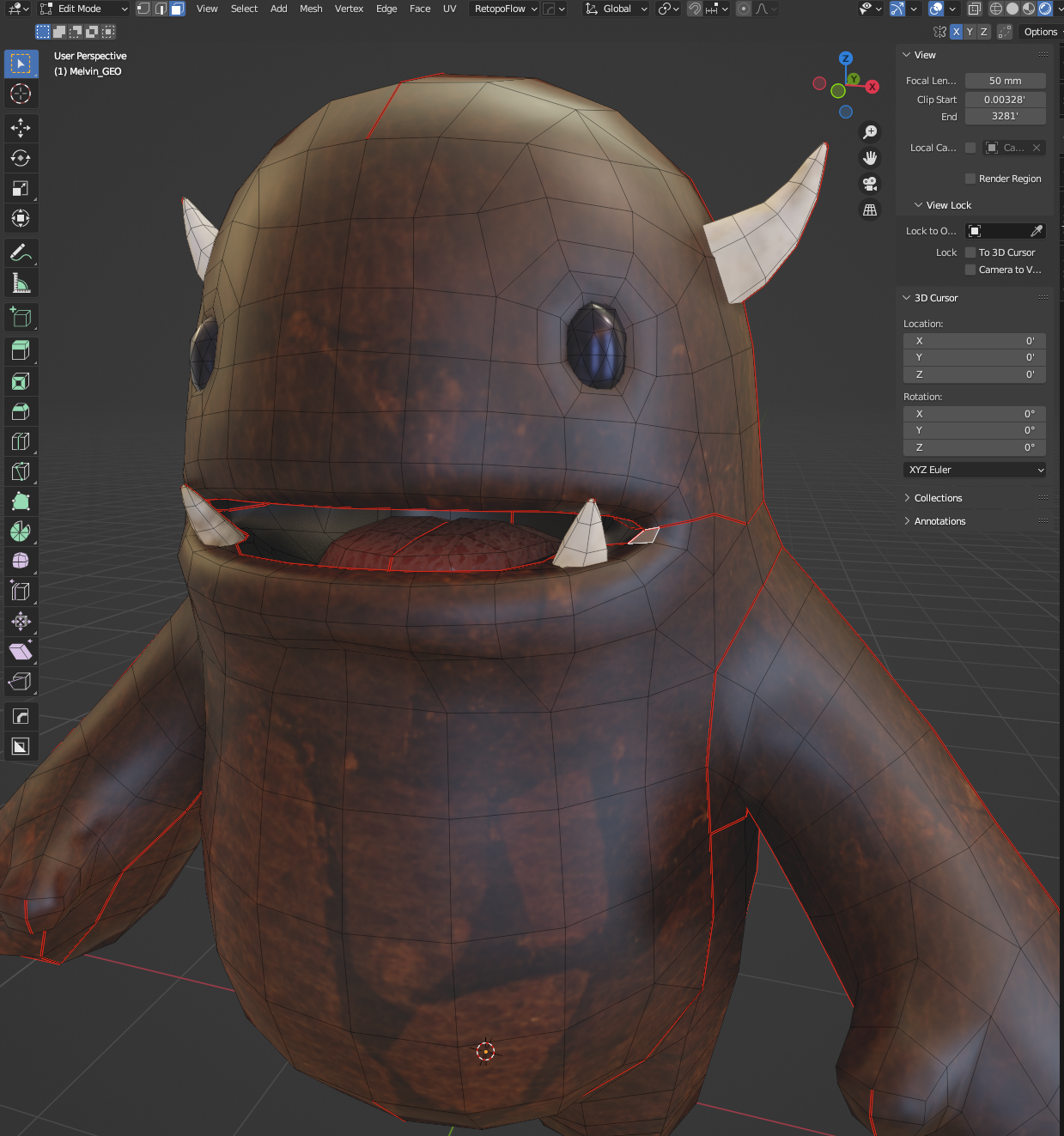

                I don’t know how I create a blank UV map once one is already created. If you hit + then it creates a copy of the previous one.
                I unwrapped Melvin tonight and added a mixed texture to see how prominent the seams were.
                Let’s say I wanted to add another UV for his eyes. How could I unwrap just the eyes to a separate UV without creating all the other faces and moving them to one side?

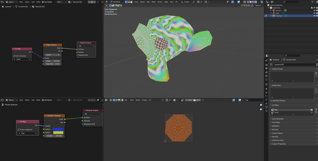

                  There is no blank UV map. If you don’t do anything, blender will do it. You can select the eyes in edit mode of the 3D viewport. Then in UV editor move them off to the side. Note: If they are attached to the rest of the mesh this is the same as selecting them in UV editor and pressing Y to separate them. If you want separate images to affect eye and body. Create 2 UV maps. One with eyes outside the bounding box area.(This is the UV you use for the body) The other will have the body outside of the bounding box area.(This is the one for the eyes.) If you want to do it all on one image then just move the islands around to make space for the eyes and move your eyes in that space. The UV editor works like 3D Viewport except it’s 2D. X left/right and Y up/down. You can use G, R, and S.
                  Another option is to separate the eyes to another object and do the UV unwrap.

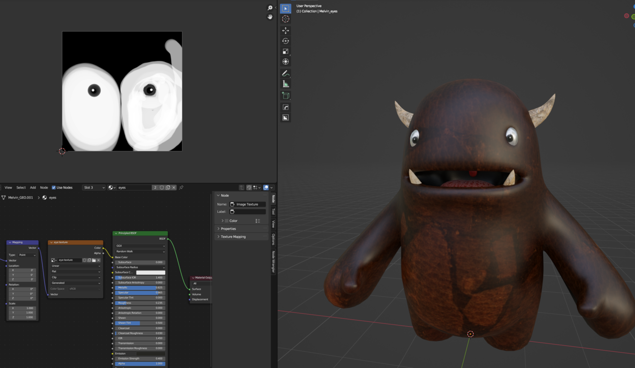

                        What I realised playing with this is because I gave the eyes (and the teeth/horns) a different material it automatically removed those faces from the UV map.
                        For now, the takeout is you can’t delete the unused UV faces and separate objects can have their own UV maps.
                        So for the eyes this is super easy to do. Select eyes, separate to a separate object, unwrap the eyes, create a new texture and paint them in.
