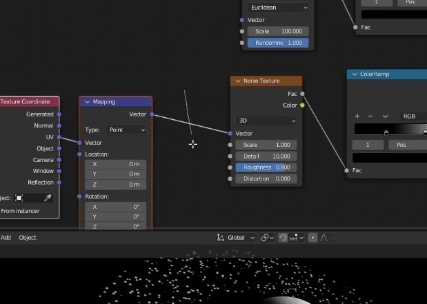

      How did you add the mapping to the vector?
      #81380
      Douglas Pendleton
        #81381
        Douglas Pendleton
          What command did you do to connect.
          #81382
            If you have the Node Wrangler Addon enabled,
            you can use CTRL+T to add a Texture Coordinates and Mapping Node when you have a Texture Node selected.
            If you press CTRL+T  with a Shader Node selected, it will also add an Image Texture Node.
            #81383
              Oh,
              I see now; you mean the Reroute Node.
              SHIFT+RMB and then drag over the Noodle. I believe that also works without the Node Wrangler.
              #81384
              Douglas Pendleton
                Thanks, I will try that tonight. I do have node wrangler activated. Thanks again.
