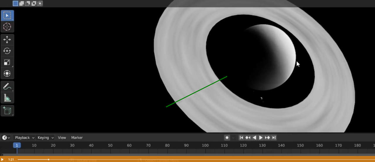

      There is a straight line boundary where the noise pattern does not match, perpendicular to the edges of the ring.
      Node setup and curve setup are the same as far as I can tell.

          There is a seam initially:
          but if you Scale the X in the Mapping Node to 0, that should be gone…
          Like Omar said, please post a Screenshot of the Node setup and 3D View if that doesn’t work.
