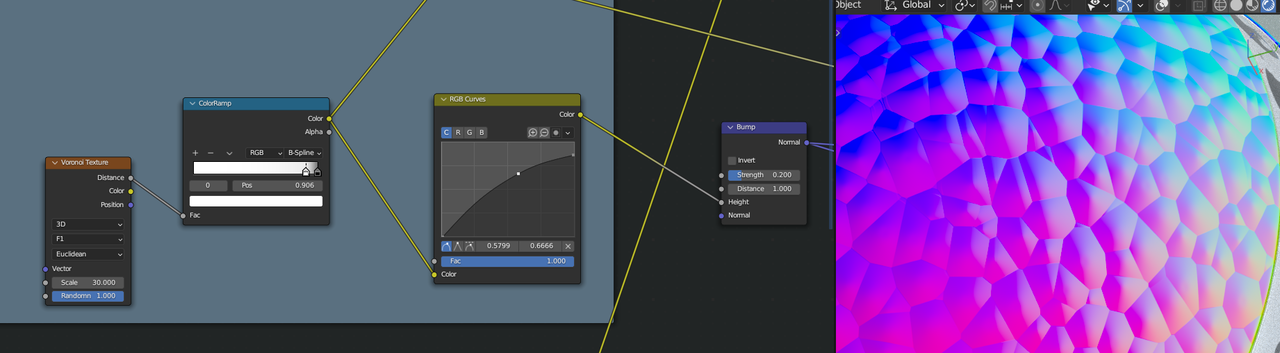

You can get it right, but the Colorramp is very sensitive. You can also add a Color > RGB Curves Node after the Colorramp, to round out the tips, something like this:

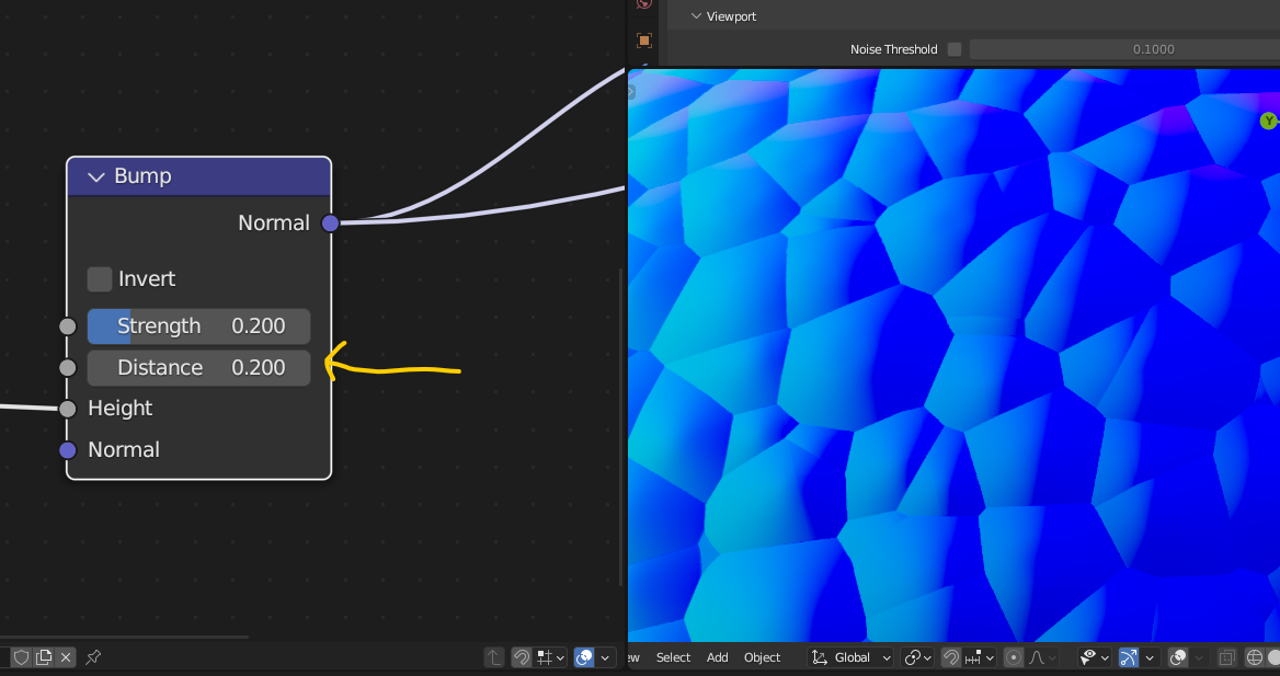

Or reduce the Distance of the Bump Node, maybe then increase the Strength a bit to compensate…
