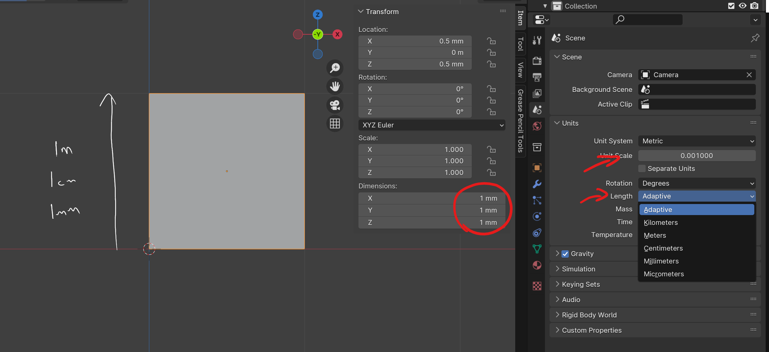

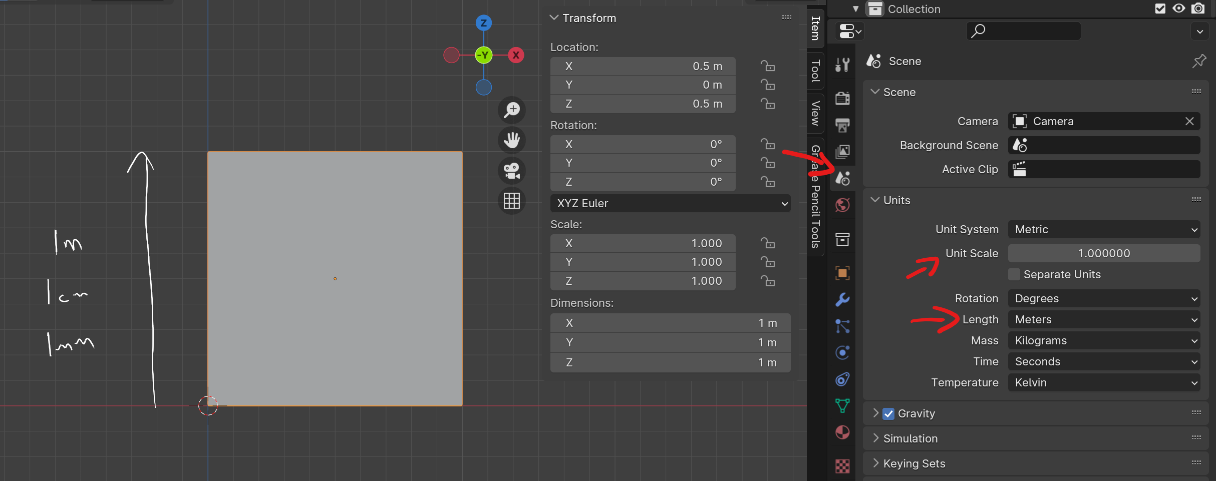

The default is meters, when the unit scale is set to 1.0 but you can adjust using the Unit scale.
If we make our unit scale 0.001 (1mm is 1/1000th of 1m) and set length to adaptive, then the units will change accordingly.
