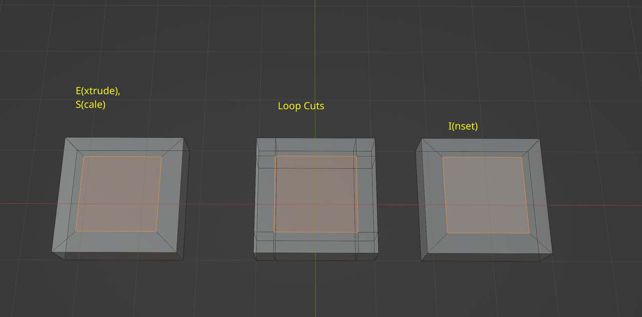

    without a timestamp, I have no idea what extrusion you are talking about, but there are almost always more than one way to get the same result. If your method works here, you can certainly use that…
    Here is an example, Extrude and Scale gives the same result as Inset, but CTRL+R is a lot more work (has to be performed twice) and results in a lot more Edges…
