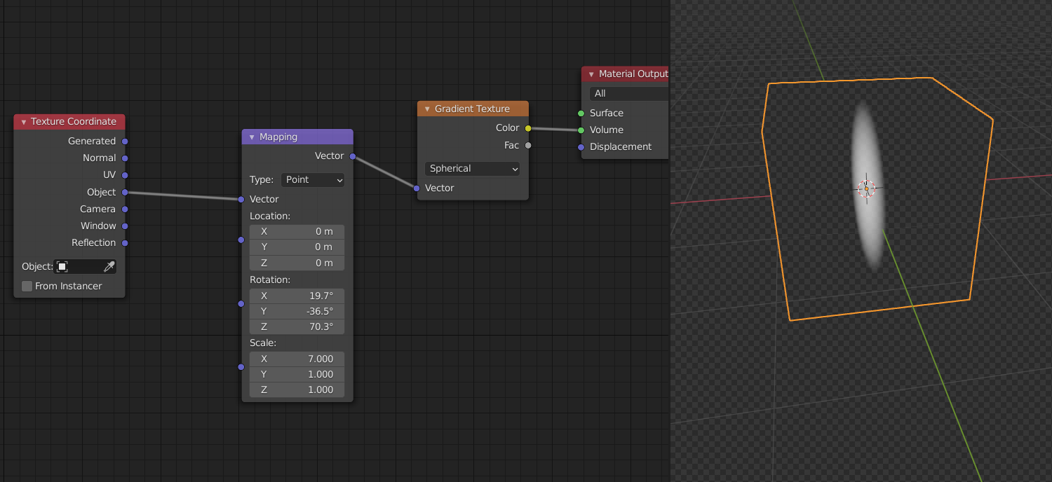

    Sorry for the late response.
    The order in which the transforms are done are Location, Rotation and Scale (with the default Point Setting).
    Here you can see that the Rotation is done first (on the sphere,thus having no visible effect) and then it is scaled along the X-axis:
