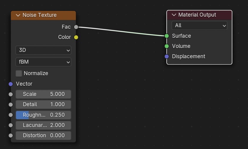

Yes the Musgrave has been integrated into the Noise texture and now the Musgrave is no more. You can either use the same Blender version JL is using in the video, or you can try and emulate the Musgrave settings with the noise texture.
This setup could give you the Musgrave pattern, I haven’t tested it though, it was a setup from Furlong.
