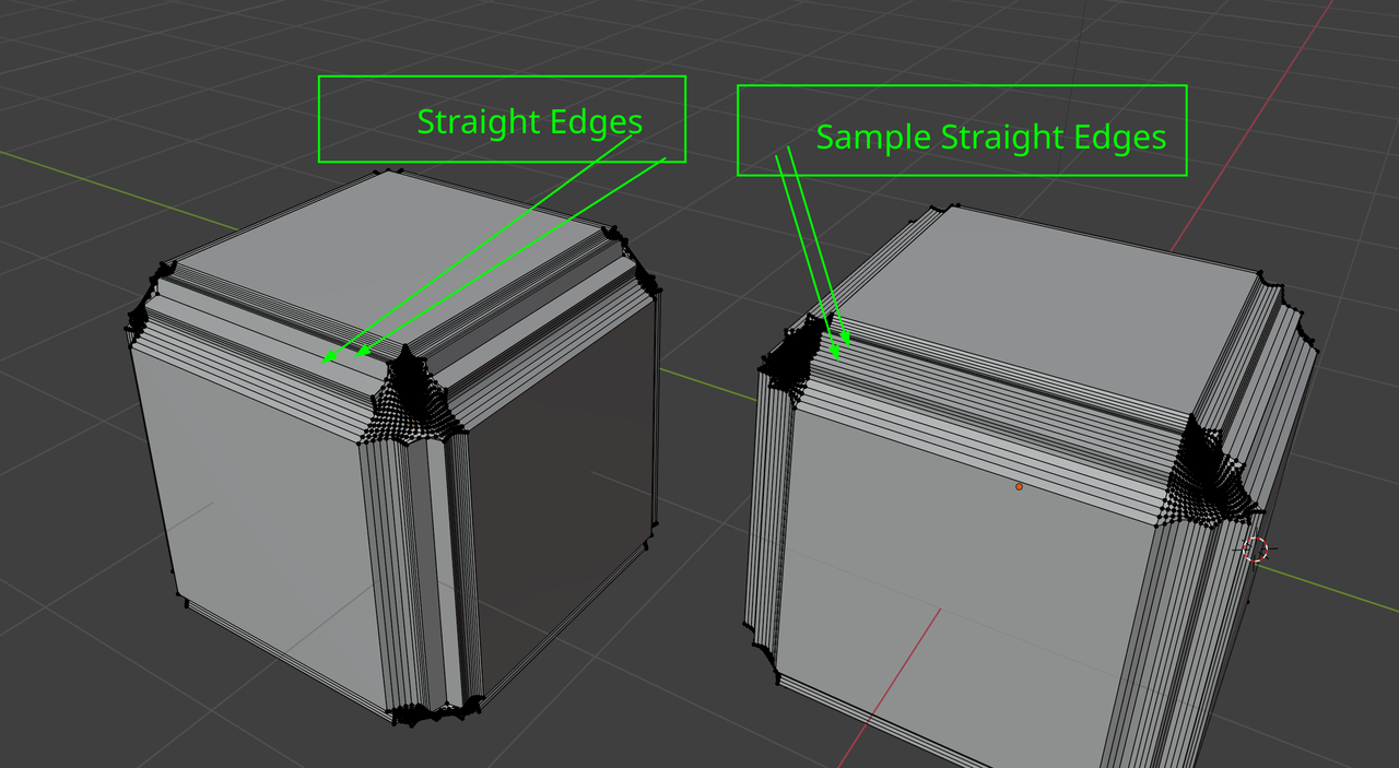

    It is about how the Edges are ‘subdivided’…you can see the effect in Edit Mode after Applying the Bevel Modifier):

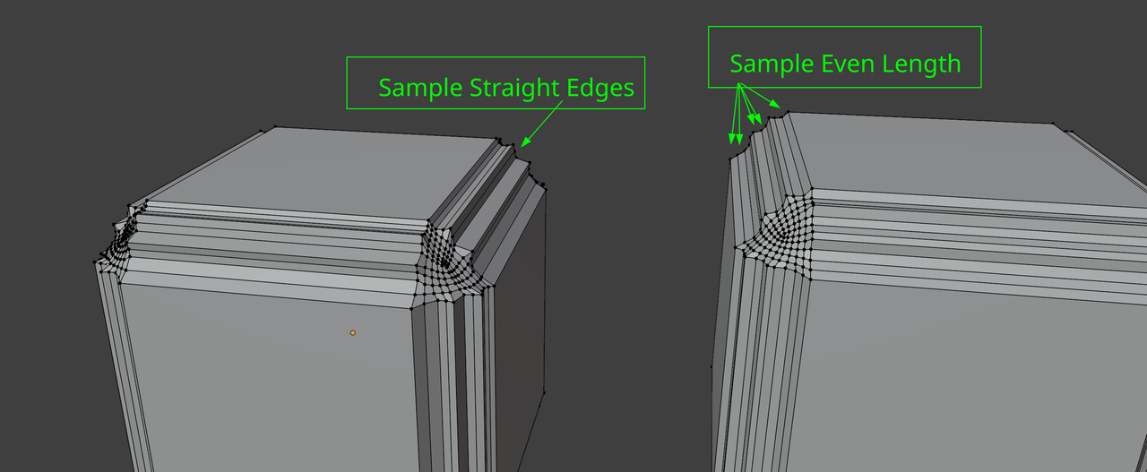

    And:
    And I must admit, that I didn’t know this, before you asked…
    Like Omar said, you’ll probably never touch those Settings.
    And be aware, that Sample Even Lengths can alter your Custom Profile.
