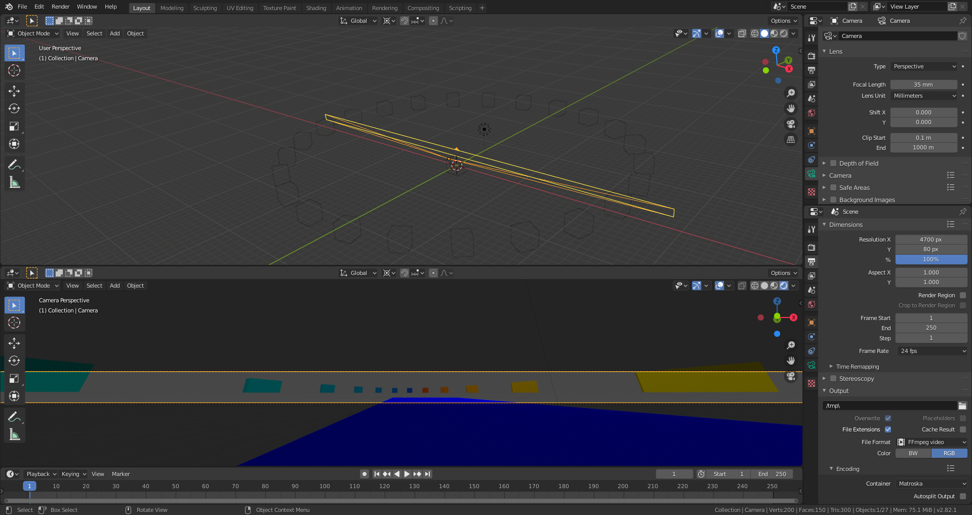

    Where I’m still wondering is why in the last image from above the camera has zoomed out when switching from “Auto Sensor Fit” to “Vertical Sensor Fit” although the focal length is still 35mm and the image sensor width hasn’t changed.
    With a render image size of 4700 x 80 und “Vertical Sensor Fit” the output image looks as if taken with a wide angle lens at a viewing angle of 180 degrees:
     I don’t know whether this would be the case if there where a real digital camera where you could select such an extreme format.
