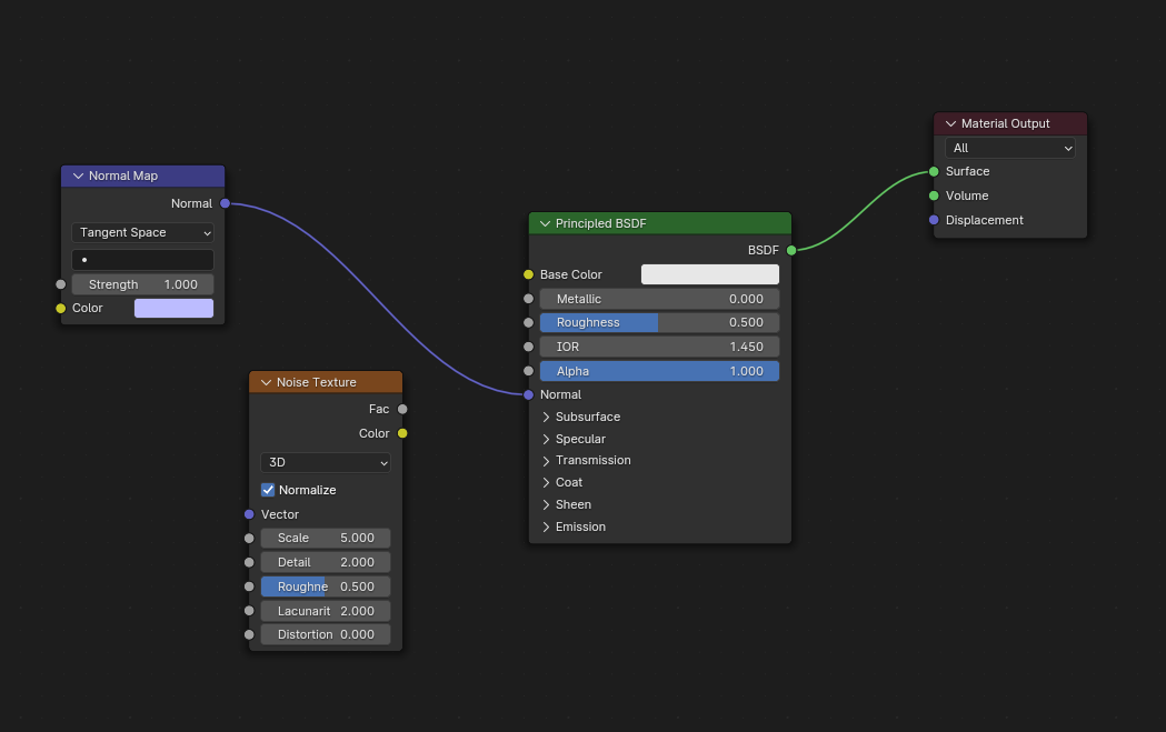

And if you need to bake like a normal map, would you do as in the picture? And then press baking in the render options, and then you would have baked a normal map? Or does it need to involve a texture?
Is this closer to understanding it? 🙂
