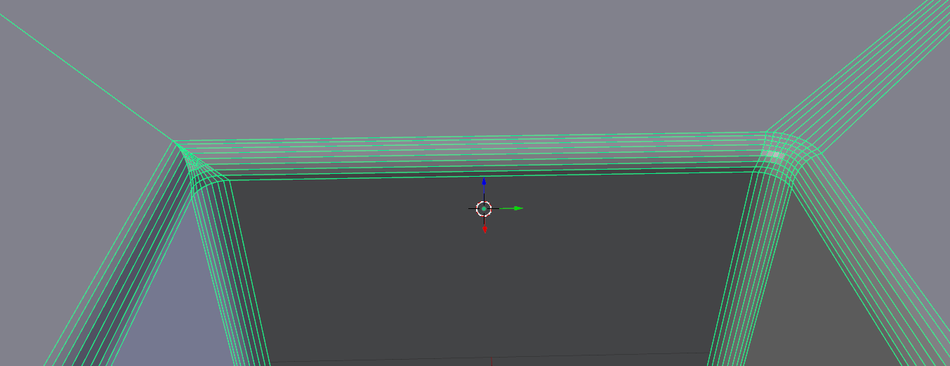

    Oh I see, so the difference is that one of the top edges is being beveled while the other one is not:
    If none of the automatic Limit Method options are working, you can set it to Weight and then assign the bevels manually from the Transform section of the viewport properties panel.
