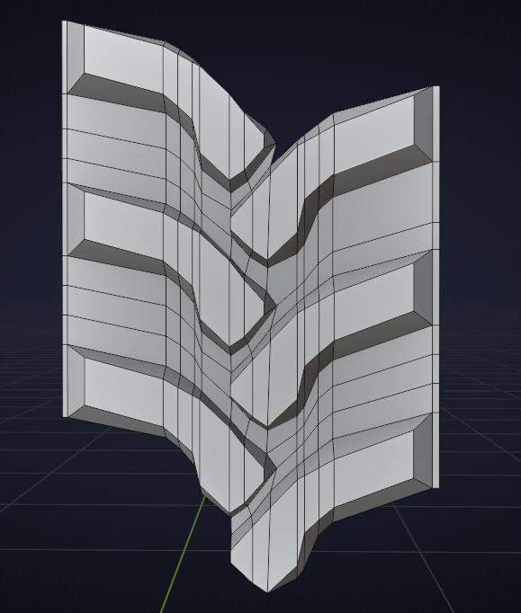

Duplicate the treads and move the duplicates up. Shift R to repeat that (so the moving distance will be the same as the first time).
Connect those pieces like so:

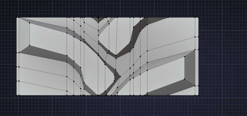

Make two straight cuts to make one segment and remove the unnecessary vertices:
Don’t forget to set the Relative Offset back to 1:

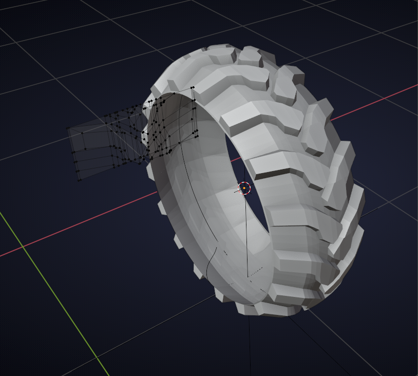

Still needs some topology cleanup, but it’s a gap-less tyre at least;)
