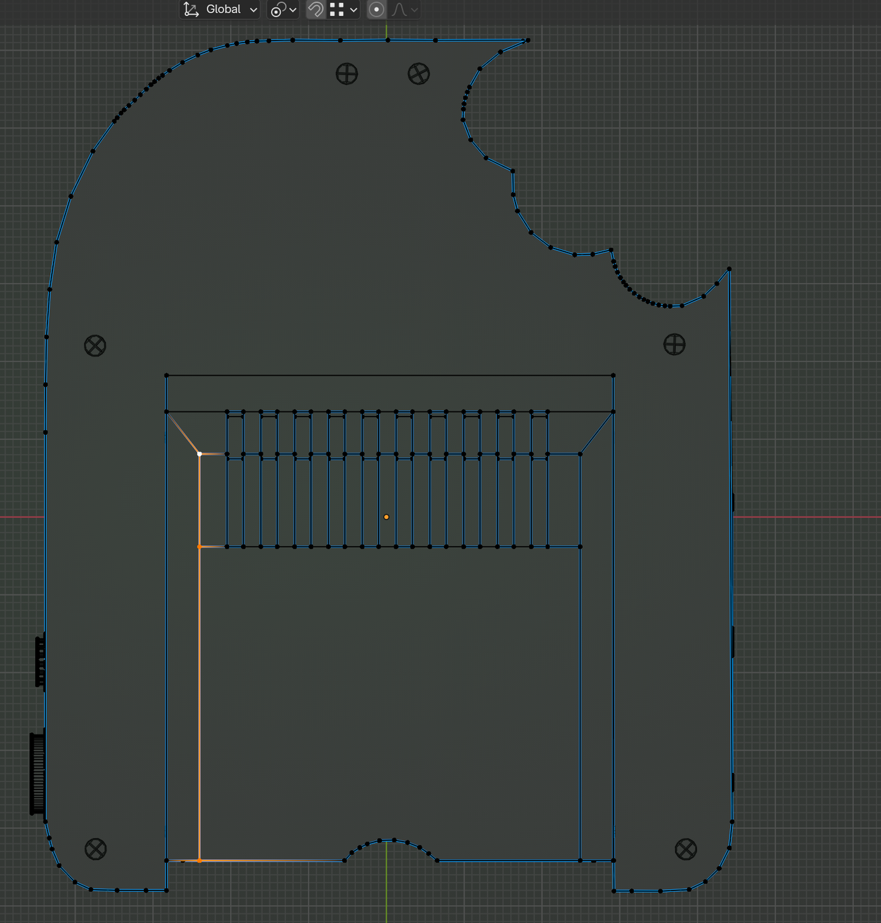

    Hi @shreef ,
    There are a few things wrong.

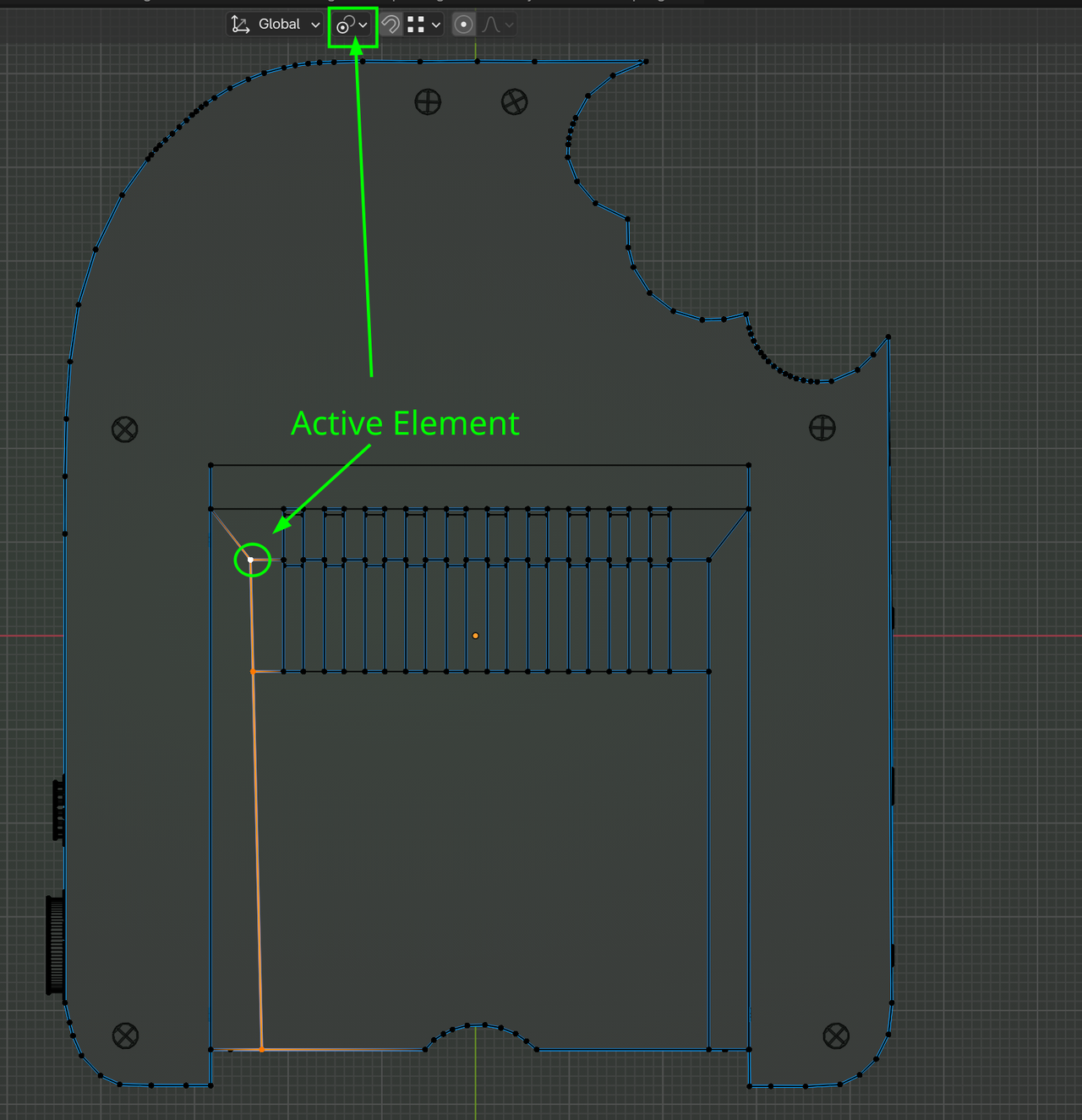

    First, these two Edges don’t go straight ‘down’:
    If you set it up like this, you can use S, X, 0 (zero) to get it straight:

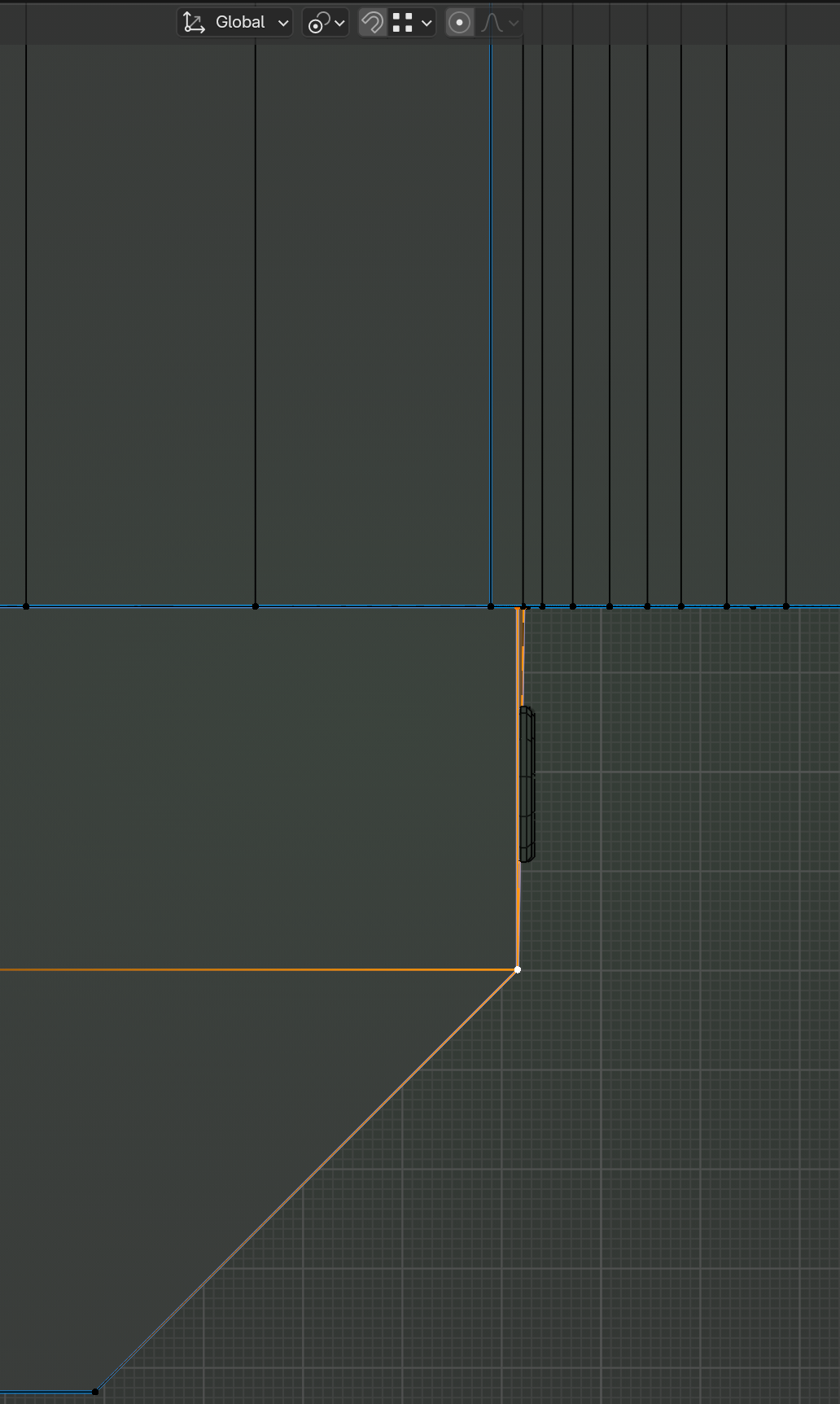

    This Face on the side is not flat:
    Same trick as above to fix it.

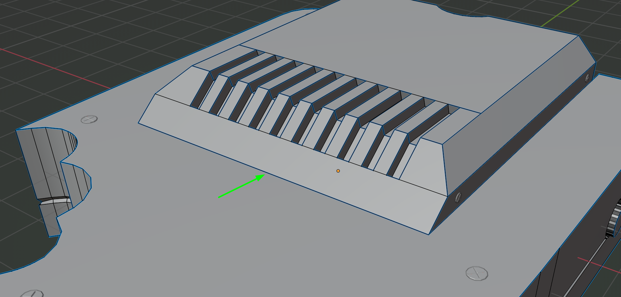

    I think you also need some Bevel Weight on this Edge:
    Then everything should work. (Maybe also reduce the Bevel Amount a bit.)
