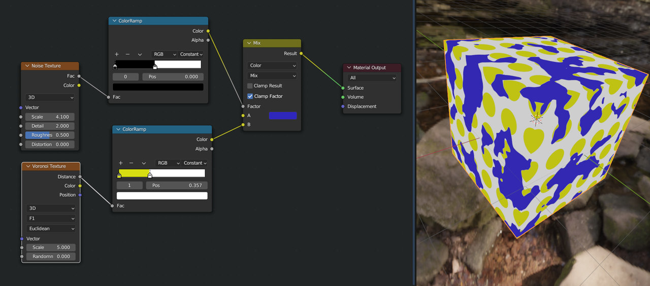

    If I understand it correctly, you mean something like this:
    Make sure that whatever you plug into the Factor of the Mix Node can only be 0 or 1.
    I used a Colorramp set to Constant, but a Math Node set to Greater Than, or so would also work.
