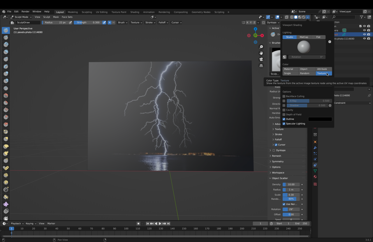

    0 at 12.24.32 PM.pngLike Omar said: Go to viewport shading. Then look within Color to see Texture below lightning. You may have to also mess with it in Image (located in properties panel) like Martin said.
