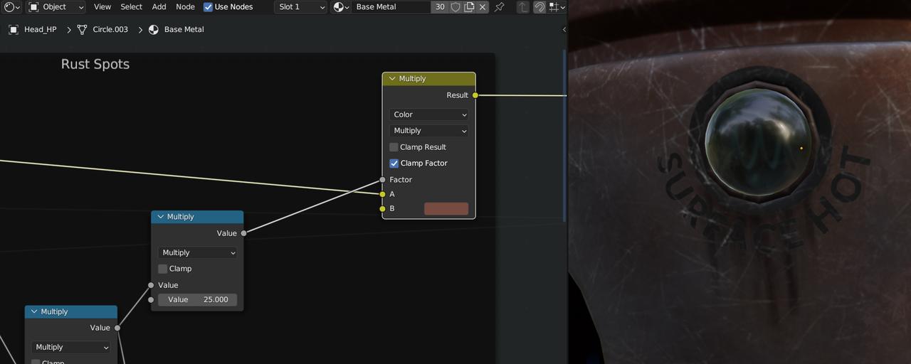

    That is excellent @Kno0ne ,
    I think the problem is with the highlighted MixRGB Node, you have set it to Mix, which makes it blend in with the second color, more when the Factor gets higher. As the text is quite dark, I would suggest setting it to Multiply:
    And yes, your Mix Node looks a bit different, but I am using 3.4…that is what it will look like in the future.
