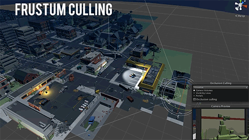

    For rendering only what the camera sees, this is known as frustum culling and is already done by default in Unity. I wrote about the different culling systems used with the camera in this article: https://blog.cgcookie.com/maximizing-your-unity-games-performance/ . Take a look at #5 within the list and you’ll see an example of it. Here is the gif from there:
    I haven’t covered occlusion culling in a tutorial but it’s fairly simple to go over. I can probably post a small video on it or create a post here on how to do it.
