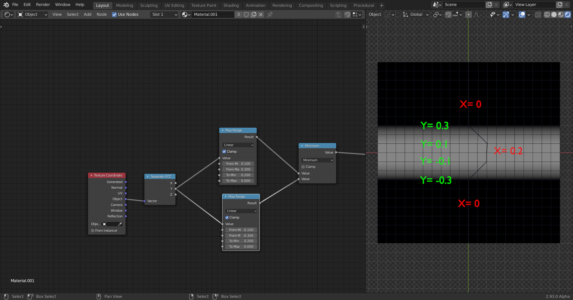

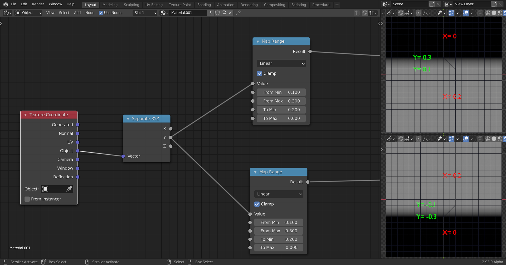

    Another picture; the two Map Range Nodes:

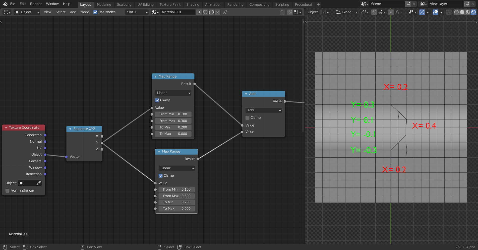

    Adding them together:
    (Which was not the best idea ever…better would have been to take the Minimum of the two:
    Then these values for X are Subtracted from the normal X values. So where Y=0, X=0.4 gets the value 0,where X=0.5 it becomes 0.1, and so on.
    Now the point (0.7, 0)) has the value 0.3 (while we subtracted 0.4 from the X-value) and the point (0.3, 0.5) also has the value 0.3 (while there we subtracted 0 from the original X-value).
    So if we then compare the values in these two points, both are within 0.25 this is called Epsilon in the Compare Node) distance from 0.000( Value in the Compare Node).
